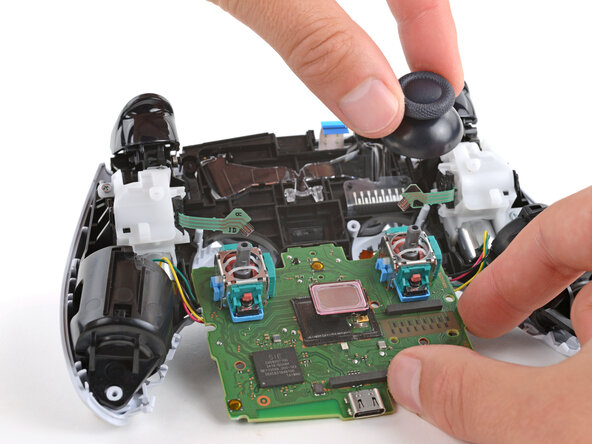

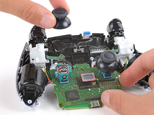

  23. DualSense Controller V5 Joystick Covers Replacement, Reposition the motherboard: crwdns2935265:023crwdnd2935265:01crwdnd2935265:02crwdne2935265:0 DualSense Controller V5 Joystick Covers Replacement, Reposition the motherboard: crwdns2935265:023crwdnd2935265:02crwdnd2935265:02crwdne2935265:0
    • Throughout the rest of your repair, be very careful not to strain the delicate wires attached to the bottom edge of the board. They can easily tear, requiring soldering to fix them.
    • Use your fingers to gently push the joysticks through their cutouts on the shell to separate the motherboard.
  24. DualSense Controller V5 Joystick Covers Replacement: crwdns2935265:024crwdnd2935265:01crwdnd2935265:02crwdne2935265:0 DualSense Controller V5 Joystick Covers Replacement: crwdns2935265:024crwdnd2935265:02crwdnd2935265:02crwdne2935265:0
    • Carefully flip the motherboard down so the joysticks are facing up.
  25. DualSense Controller V5 Joystick Covers Replacement, Speaker note: crwdns2935265:025crwdnd2935265:01crwdnd2935265:02crwdne2935265:0 DualSense Controller V5 Joystick Covers Replacement, Speaker note: crwdns2935265:025crwdnd2935265:02crwdnd2935265:02crwdne2935265:0
    • The speaker may have fallen out when repositioning the motherboard. If it did, set it aside for reassembly. If it stayed in place on the motherboard or is in its recess in the front case, you can leave it in place.
    • During reassembly, place the speaker in its recess so the foam pad is on the left and the spring contacts are on the right.
  26. DualSense Controller V5 Joystick Covers Replacement, Remove the joystick covers: crwdns2935265:026crwdnd2935265:01crwdnd2935265:03crwdne2935265:0 DualSense Controller V5 Joystick Covers Replacement, Remove the joystick covers: crwdns2935265:026crwdnd2935265:02crwdnd2935265:03crwdne2935265:0 DualSense Controller V5 Joystick Covers Replacement, Remove the joystick covers: crwdns2935265:026crwdnd2935265:03crwdnd2935265:03crwdne2935265:0
    • Secure the motherboard with one hand, and use your free hand to pull the joystick covers straight up to remove them.
