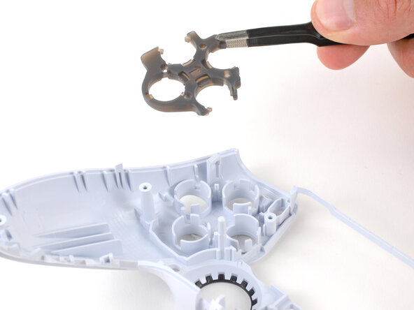

  29. DualSense Controller V5 Front Case Replacement: crwdns2935265:029crwdnd2935265:01crwdnd2935265:03crwdne2935265:0 DualSense Controller V5 Front Case Replacement: crwdns2935265:029crwdnd2935265:02crwdnd2935265:03crwdne2935265:0 DualSense Controller V5 Front Case Replacement: crwdns2935265:029crwdnd2935265:03crwdnd2935265:03crwdne2935265:0
    • Use tweezers or your fingers to remove the three silicone pads covering the Action, PS, and Directional buttons.
  30. DualSense Controller V5 Front Case Replacement: crwdns2935265:030crwdnd2935265:01crwdnd2935265:03crwdne2935265:0 DualSense Controller V5 Front Case Replacement: crwdns2935265:030crwdnd2935265:02crwdnd2935265:03crwdne2935265:0 DualSense Controller V5 Front Case Replacement: crwdns2935265:030crwdnd2935265:03crwdnd2935265:03crwdne2935265:0
    • Use tweezers or your fingers to remove the Action, PS, and Directional buttons.
    • Alternatively, you can slowly flip the front case over to let the buttons fall out.
    • During reassembly, use the alignment tabs to orient each button into its recess—each one is keyed specifically for its recess and proper orientation.

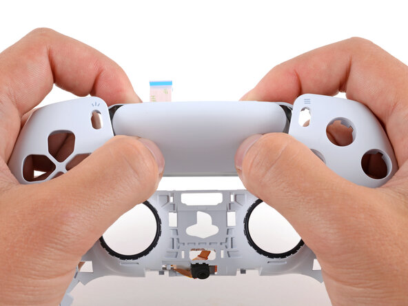

  32. DualSense Controller V5 Front Case Replacement, Remove the touchpad: crwdns2935265:032crwdnd2935265:01crwdnd2935265:02crwdne2935265:0 DualSense Controller V5 Front Case Replacement, Remove the touchpad: crwdns2935265:032crwdnd2935265:02crwdnd2935265:02crwdne2935265:0
    • Use your fingers to push down on the front of the touchpad until it detaches from the shell.
    • You should feel and hear a "click" as the touchpad detaches.

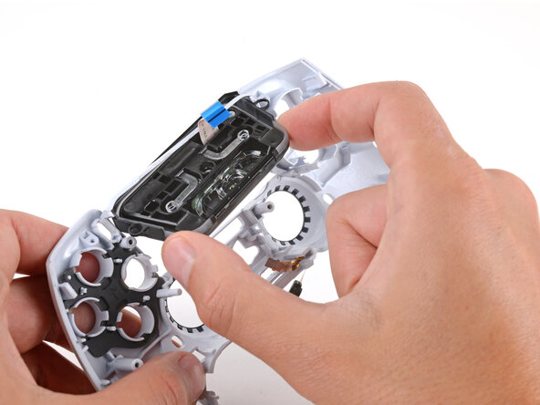

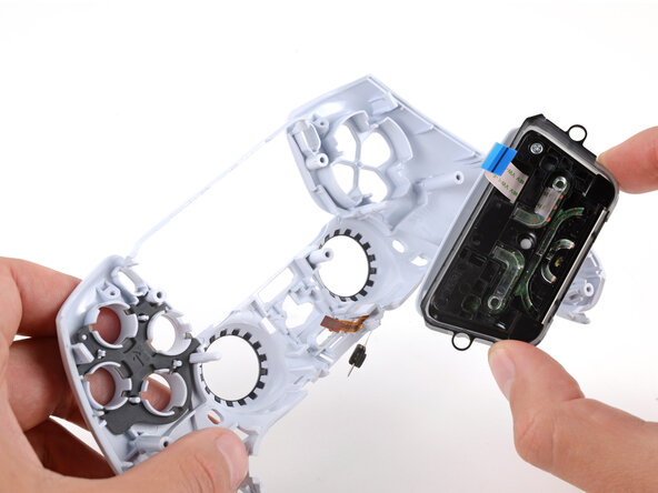

  33. DualSense Controller V5 Front Case Replacement: crwdns2935265:033crwdnd2935265:01crwdnd2935265:03crwdne2935265:0 DualSense Controller V5 Front Case Replacement: crwdns2935265:033crwdnd2935265:02crwdnd2935265:03crwdne2935265:0 DualSense Controller V5 Front Case Replacement: crwdns2935265:033crwdnd2935265:03crwdnd2935265:03crwdne2935265:0
    • Swing the bottom of the touchpad up and away from the controller to remove it.
    • During reassembly:
    • Insert the touchpad through the back of the case and hook the top edge into place.
    • Make sure the touchpad cable doesn't get trapped between the case and the touchpad.
    • Push the bottom edge of the touchpad firmly into place, making sure the circular alignment posts snap into place and are sitting flush in their cutouts.
    • Check the front edge of the touchpad and make sure the thin strip of plastic on the front shell isn't wedged under the touchpad. If it is, remove the touchpad and reinsert it so the thin strip is parallel to the touchpad.

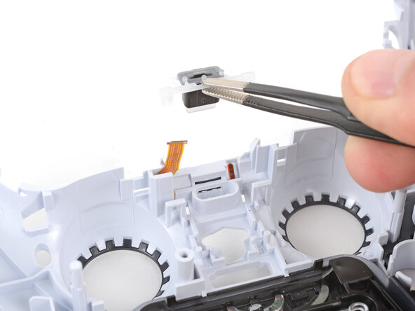

  35. DualSense Controller V5 Front Case Replacement, Remove the microphone: crwdns2935265:035crwdnd2935265:01crwdnd2935265:02crwdne2935265:0 DualSense Controller V5 Front Case Replacement, Remove the microphone: crwdns2935265:035crwdnd2935265:02crwdnd2935265:02crwdne2935265:0
    • Use tweezers to remove the microphone, threading its cable through the cutout in the case.
    • During reassembly, make sure the microphone has its rubber gasket and that the alignment tab goes into its cutout.

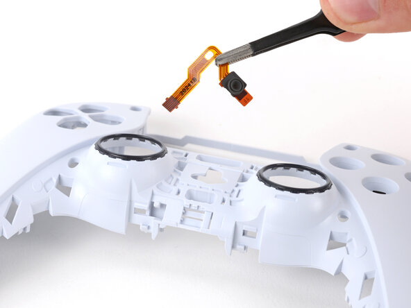

  36. DualSense Controller V5 Front Case Replacement: crwdns2935265:036crwdnd2935265:01crwdnd2935265:01crwdne2935265:0
    • You're left with the front shell.
    • During reassembly, you'll need to transfer all the parts you removed from your original front shell to the new one.
