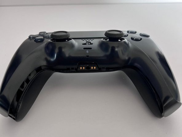

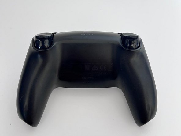

    • This controller is the black version, but this guide applies to every CFI-ZCT1W model.
    • Here is a video demonstrating how bad the controller stick drift was before the fix.
  2. DualSense Controller V2 Stick Drift Fix: crwdns2935265:03crwdnd2935265:01crwdnd2935265:03crwdne2935265:0 DualSense Controller V2 Stick Drift Fix: crwdns2935265:03crwdnd2935265:02crwdnd2935265:03crwdne2935265:0 DualSense Controller V2 Stick Drift Fix: crwdns2935265:03crwdnd2935265:03crwdnd2935265:03crwdne2935265:0

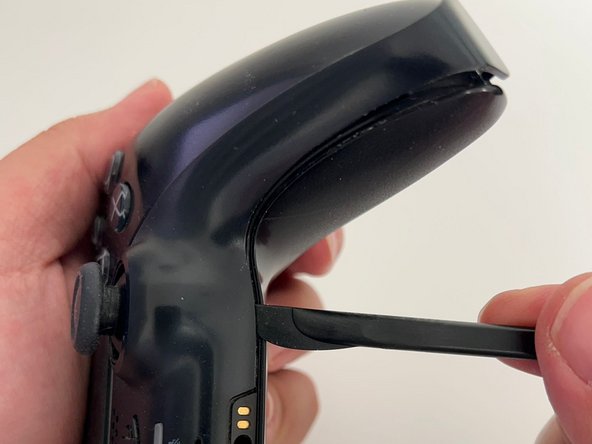

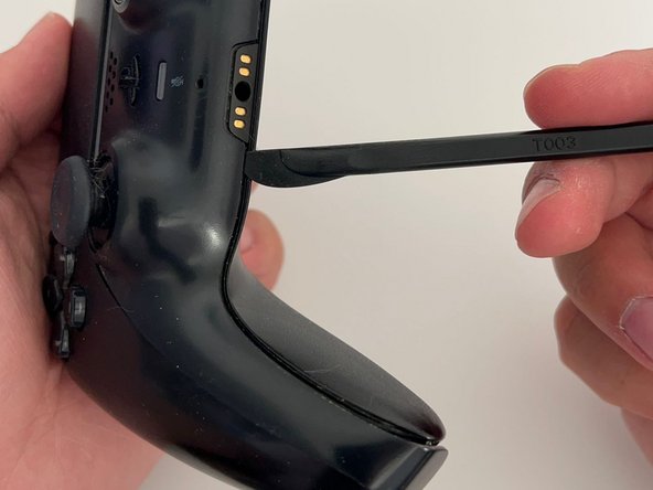

    • Insert an opening pick underneath the middle trim at the right bottom of the controller and pry it up to release the clips that secure it.
  3. DualSense Controller V2 Stick Drift Fix: crwdns2935265:04crwdnd2935265:01crwdnd2935265:02crwdne2935265:0 DualSense Controller V2 Stick Drift Fix: crwdns2935265:04crwdnd2935265:02crwdnd2935265:02crwdne2935265:0
    • Slide a pick along the lower-right edge to release the clips securing it to the case.

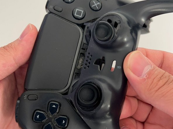

    • This is how the controller looks when all the clips are released.

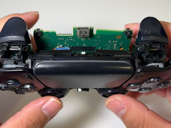

  6. DualSense Controller V2 Stick Drift Fix: crwdns2935265:07crwdnd2935265:01crwdnd2935265:03crwdne2935265:0 DualSense Controller V2 Stick Drift Fix: crwdns2935265:07crwdnd2935265:02crwdnd2935265:03crwdne2935265:0 DualSense Controller V2 Stick Drift Fix: crwdns2935265:07crwdnd2935265:03crwdnd2935265:03crwdne2935265:0

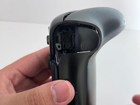

    • Use your fingers to lift up the bottom edge of the middle trim.
    • Watch out for the two pieces that are hidden underneath the touchpad.

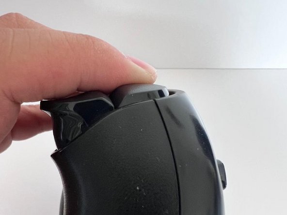

  7. DualSense Controller V2 Stick Drift Fix: crwdns2935265:08crwdnd2935265:01crwdnd2935265:03crwdne2935265:0 DualSense Controller V2 Stick Drift Fix: crwdns2935265:08crwdnd2935265:02crwdnd2935265:03crwdne2935265:0 DualSense Controller V2 Stick Drift Fix: crwdns2935265:08crwdnd2935265:03crwdnd2935265:03crwdne2935265:0

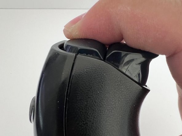

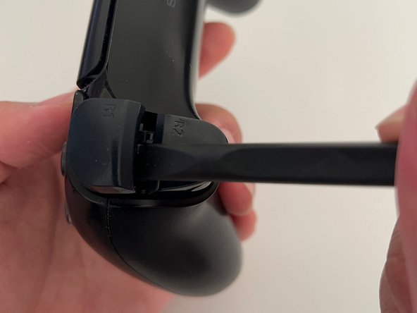

    • Insert the flat end of a spudger into the gap between L1 and L2.
    • Pry upward against L1 to remove the L1 button.
  8. DualSense Controller V2 Stick Drift Fix: crwdns2935265:09crwdnd2935265:01crwdnd2935265:02crwdne2935265:0 DualSense Controller V2 Stick Drift Fix: crwdns2935265:09crwdnd2935265:02crwdnd2935265:02crwdne2935265:0
    • Insert the flat end of a spudger into the gap between R1 and R2.
    • Pry upward against the R1 to remove the R1 button.

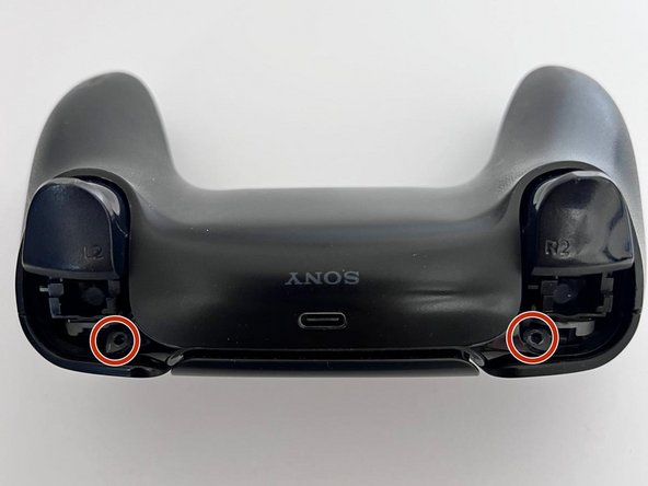

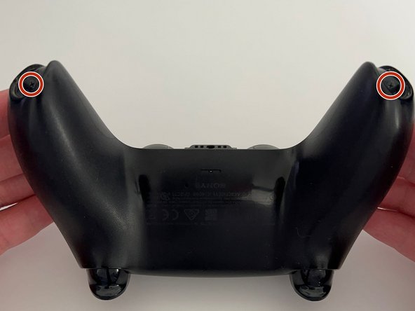

  9. DualSense Controller V2 Stick Drift Fix: crwdns2935265:010crwdnd2935265:01crwdnd2935265:02crwdne2935265:0 DualSense Controller V2 Stick Drift Fix: crwdns2935265:010crwdnd2935265:02crwdnd2935265:02crwdne2935265:0
    • Use a Phillips screwdriver to remove the two 6.4 mm screws behind the L1 and R1 buttons, as well as the two 6.4 mm screws that secure the bottom corners of the lower case.
    • You will have a total of four 6.4 mm Phillips screws. Make sure not to lose any of them.

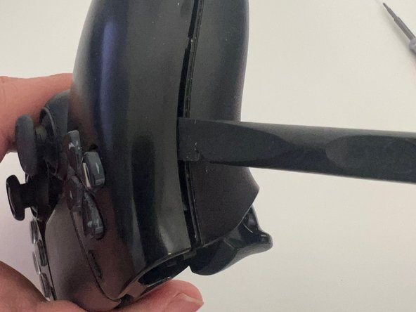

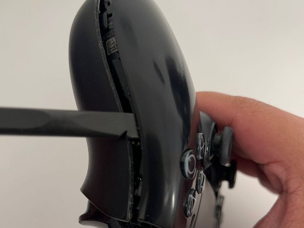

  10. DualSense Controller V2 Stick Drift Fix: crwdns2935265:011crwdnd2935265:01crwdnd2935265:03crwdne2935265:0 DualSense Controller V2 Stick Drift Fix: crwdns2935265:011crwdnd2935265:02crwdnd2935265:03crwdne2935265:0 DualSense Controller V2 Stick Drift Fix: crwdns2935265:011crwdnd2935265:03crwdnd2935265:03crwdne2935265:0
    • Use the pointed edge of a spudger to unclip the two clips on either side of the headset jack.
  11. DualSense Controller V2 Stick Drift Fix: crwdns2935265:012crwdnd2935265:01crwdnd2935265:02crwdne2935265:0 DualSense Controller V2 Stick Drift Fix: crwdns2935265:012crwdnd2935265:02crwdnd2935265:02crwdne2935265:0
    • Slide the spudger along the edge to release the clips that secure the rear case.
    • Top clips (near the triggers) are stiffer than the others and might require more force and prying to release.
  12. DualSense Controller V2 Stick Drift Fix: crwdns2935265:013crwdnd2935265:01crwdnd2935265:02crwdne2935265:0 DualSense Controller V2 Stick Drift Fix: crwdns2935265:013crwdnd2935265:02crwdnd2935265:02crwdne2935265:0
    • Same as the other side, slide the spudger along the edge to release the clips that secure the rear case.
  13. DualSense Controller V2 Stick Drift Fix: crwdns2935265:014crwdnd2935265:01crwdnd2935265:01crwdne2935265:0

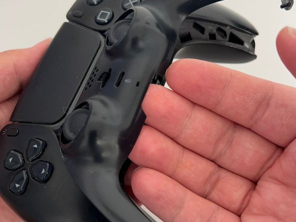

    • Remove the rear case.

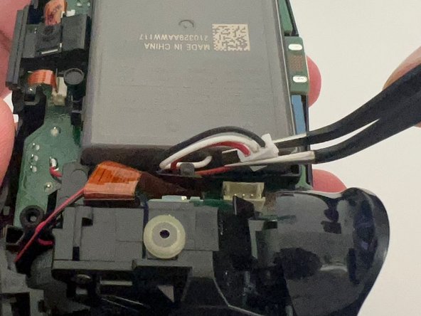

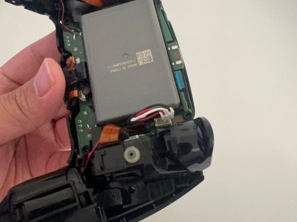

  14. DualSense Controller V2 Stick Drift Fix: crwdns2935265:015crwdnd2935265:01crwdnd2935265:03crwdne2935265:0 DualSense Controller V2 Stick Drift Fix: crwdns2935265:015crwdnd2935265:02crwdnd2935265:03crwdne2935265:0 DualSense Controller V2 Stick Drift Fix: crwdns2935265:015crwdnd2935265:03crwdnd2935265:03crwdne2935265:0
    • Use tweezers or your fingers to disconnect the battery from the motherboard.
    • To prevent damaging the wire, grip the white connector, not the wires.

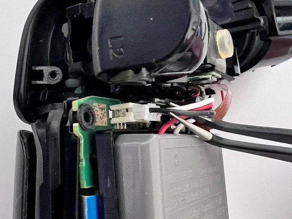

  15. DualSense Controller V2 Stick Drift Fix: crwdns2935265:016crwdnd2935265:01crwdnd2935265:01crwdne2935265:0
    • Use tweezers to disconnect the upper and lower microphone cables.
    • Use the pull tabs to disconnect the cables. Don't pull on the cables themselves.

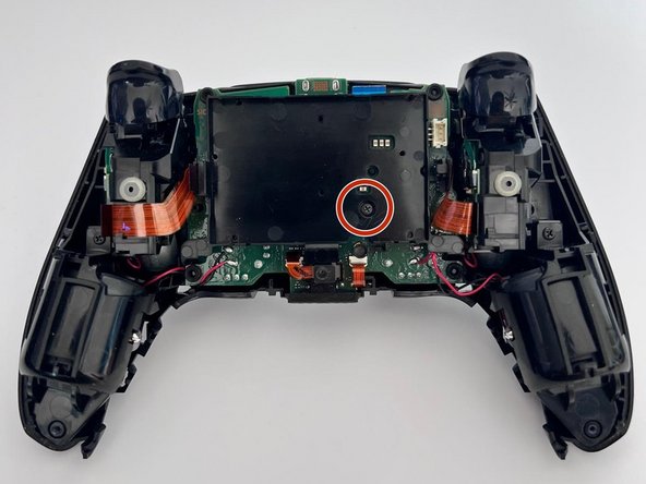

  16. DualSense Controller V2 Stick Drift Fix: crwdns2935265:017crwdnd2935265:01crwdnd2935265:03crwdne2935265:0 DualSense Controller V2 Stick Drift Fix: crwdns2935265:017crwdnd2935265:02crwdnd2935265:03crwdne2935265:0 DualSense Controller V2 Stick Drift Fix: crwdns2935265:017crwdnd2935265:03crwdnd2935265:03crwdne2935265:0
    • Use a Phillips screwdriver to remove the single 6.4 mm screw that secures the battery bracket.
    • Remove the battery bracket.
    • At this point, you will have a total of five 6.4 mm Phillips screws.

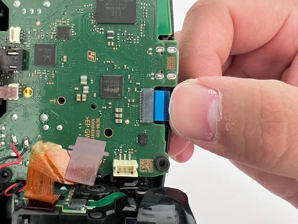

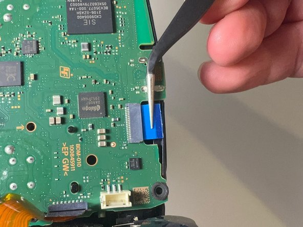

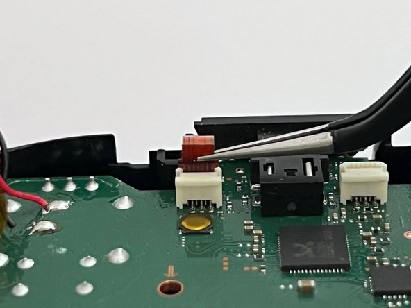

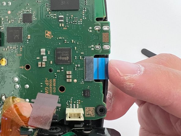

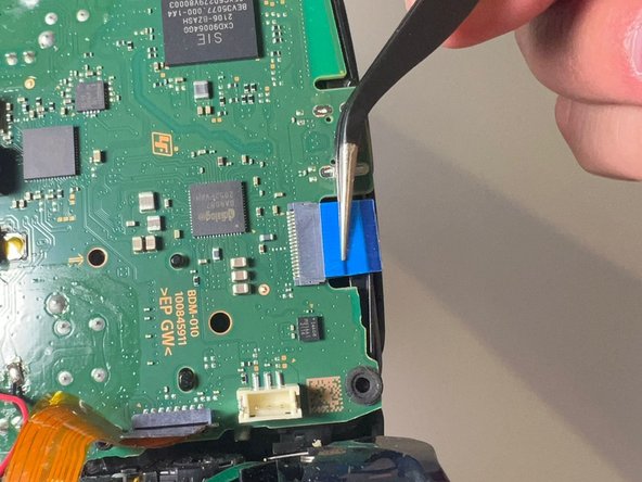

  17. DualSense Controller V2 Stick Drift Fix: crwdns2935265:018crwdnd2935265:01crwdnd2935265:03crwdne2935265:0 DualSense Controller V2 Stick Drift Fix: crwdns2935265:018crwdnd2935265:02crwdnd2935265:03crwdne2935265:0 DualSense Controller V2 Stick Drift Fix: crwdns2935265:018crwdnd2935265:03crwdnd2935265:03crwdne2935265:0
    • Use a pair of tweezers to grip the touchpad ribbon cable, and pull it out of the motherboard.

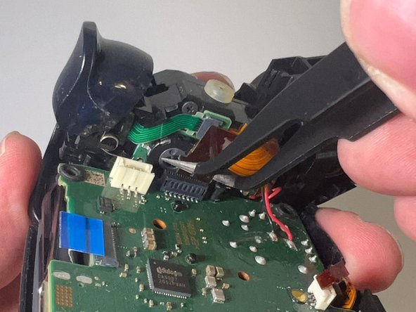

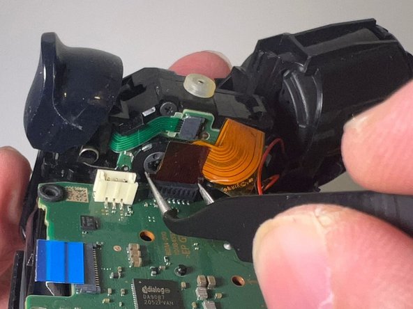

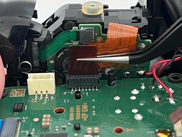

  18. DualSense Controller V2 Stick Drift Fix: crwdns2935265:019crwdnd2935265:01crwdnd2935265:03crwdne2935265:0 DualSense Controller V2 Stick Drift Fix: crwdns2935265:019crwdnd2935265:02crwdnd2935265:03crwdne2935265:0 DualSense Controller V2 Stick Drift Fix: crwdns2935265:019crwdnd2935265:03crwdnd2935265:03crwdne2935265:0
    • Use a pair of tweezers to disconnect the right trigger ribbon cable.
    • Use the pull tab to disconnect the cable. Don't pull on the cable itself.
  19. DualSense Controller V2 Stick Drift Fix: crwdns2935265:020crwdnd2935265:01crwdnd2935265:03crwdne2935265:0 DualSense Controller V2 Stick Drift Fix: crwdns2935265:020crwdnd2935265:02crwdnd2935265:03crwdne2935265:0 DualSense Controller V2 Stick Drift Fix: crwdns2935265:020crwdnd2935265:03crwdnd2935265:03crwdne2935265:0
    • Use a pair of tweezers to disconnect the left trigger ribbon cable from the motherboard.

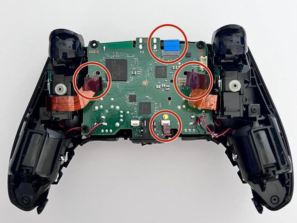

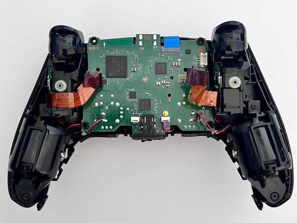

  20. DualSense Controller V2 Stick Drift Fix: crwdns2935265:021crwdnd2935265:01crwdnd2935265:01crwdne2935265:0
    • Make sure you have disconnected the four ribbon cables from the motherboard before moving on to the next step.

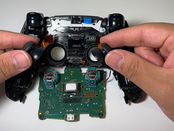

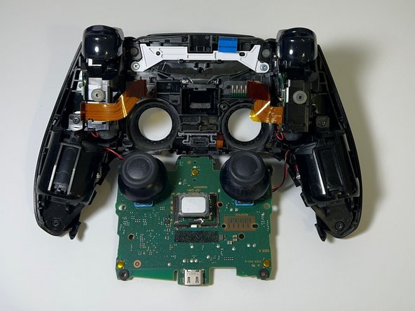

  21. DualSense Controller V2 Stick Drift Fix: crwdns2935265:022crwdnd2935265:01crwdnd2935265:03crwdne2935265:0 DualSense Controller V2 Stick Drift Fix: crwdns2935265:022crwdnd2935265:02crwdnd2935265:03crwdne2935265:0 DualSense Controller V2 Stick Drift Fix: crwdns2935265:022crwdnd2935265:03crwdnd2935265:03crwdne2935265:0

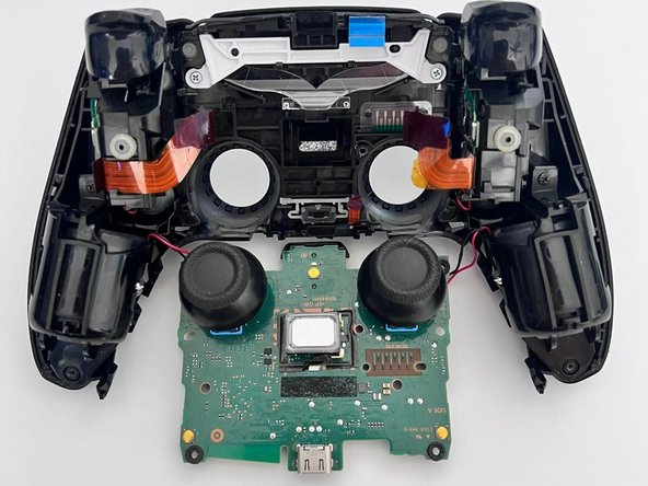

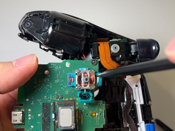

    • Gently push the joysticks to separate the motherboard from the case.
    • The motherboard and the case are still connected through 4 soldered wires. Take care not to strain them.
  22. DualSense Controller V2 Stick Drift Fix: crwdns2935265:023crwdnd2935265:01crwdnd2935265:02crwdne2935265:0 DualSense Controller V2 Stick Drift Fix: crwdns2935265:023crwdnd2935265:02crwdnd2935265:02crwdne2935265:0
    • Use your fingers to pull the joystick covers straight up and off.

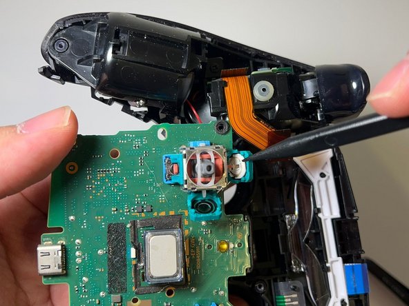

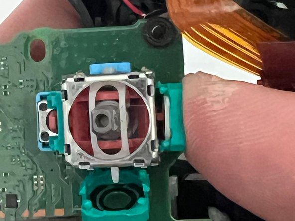

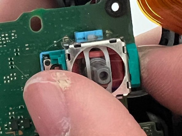

    • Use a spudger to pry the drifting joystick potentiometer slots open.
    • Pry open the potentiometer slot gently or you will damage the slot.

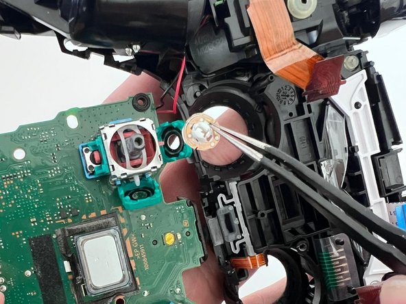

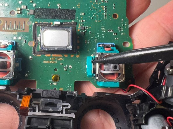

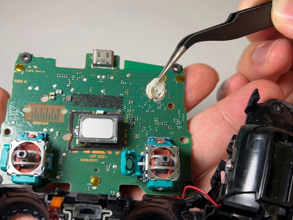

  24. DualSense Controller V2 Stick Drift Fix: crwdns2935265:025crwdnd2935265:01crwdnd2935265:02crwdne2935265:0 DualSense Controller V2 Stick Drift Fix: crwdns2935265:025crwdnd2935265:02crwdnd2935265:02crwdne2935265:0
    • Use tweezers to remove the wiper.
    • Try to keep the slots down to about only 60o. Completely prying it open will damage the slots and they will not be able to close.
  25. DualSense Controller V2 Stick Drift Fix: crwdns2935265:026crwdnd2935265:01crwdnd2935265:03crwdne2935265:0 DualSense Controller V2 Stick Drift Fix: crwdns2935265:026crwdnd2935265:02crwdnd2935265:03crwdne2935265:0 DualSense Controller V2 Stick Drift Fix: crwdns2935265:026crwdnd2935265:03crwdnd2935265:03crwdne2935265:0
    • Repeat the previous step for the other potentiometer.
  26. DualSense Controller V2 Stick Drift Fix: crwdns2935265:027crwdnd2935265:01crwdnd2935265:02crwdne2935265:0 DualSense Controller V2 Stick Drift Fix: crwdns2935265:027crwdnd2935265:02crwdnd2935265:02crwdne2935265:0
    • Use a pair of tweezers to remove the wiper.
  27. DualSense Controller V2 Stick Drift Fix: crwdns2935265:028crwdnd2935265:01crwdnd2935265:02crwdne2935265:0 DualSense Controller V2 Stick Drift Fix: crwdns2935265:028crwdnd2935265:02crwdnd2935265:02crwdne2935265:0

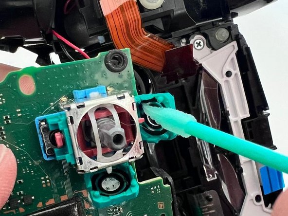

    • Dampen a cotton swab with high-concentration isopropyl alcohol.
    • Flip the wiper to the other side and use the damp cotton swab to rub off any gunk or grease.
    • Repeat this step for the other wiper.
  28. DualSense Controller V2 Stick Drift Fix: crwdns2935265:029crwdnd2935265:01crwdnd2935265:02crwdne2935265:0 DualSense Controller V2 Stick Drift Fix: crwdns2935265:029crwdnd2935265:02crwdnd2935265:02crwdne2935265:0
    • Use a cotton swab damp with high-concentration isopropyl alcohol to clean the inside of both of the potentiometer slots.
  29. DualSense Controller V2 Stick Drift Fix: crwdns2935265:030crwdnd2935265:01crwdnd2935265:03crwdne2935265:0 DualSense Controller V2 Stick Drift Fix: crwdns2935265:030crwdnd2935265:02crwdnd2935265:03crwdne2935265:0 DualSense Controller V2 Stick Drift Fix: crwdns2935265:030crwdnd2935265:03crwdnd2935265:03crwdne2935265:0
