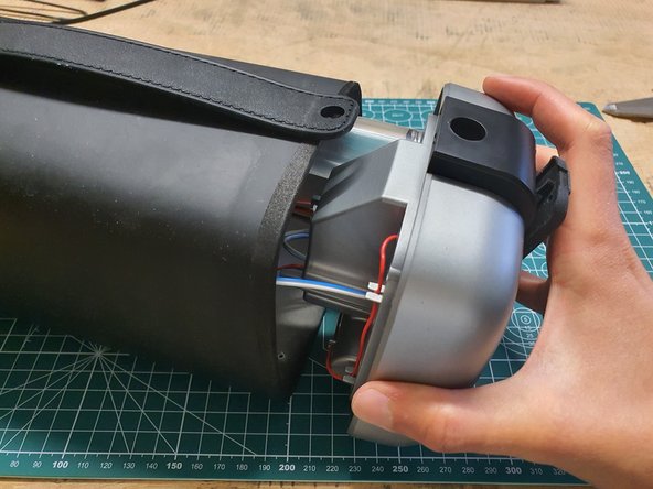

  3. Dual BT 10 Mainboard Disassembly, Removing the front housing: crwdns2935265:03crwdnd2935265:01crwdnd2935265:02crwdne2935265:0 Dual BT 10 Mainboard Disassembly, Removing the front housing: crwdns2935265:03crwdnd2935265:02crwdnd2935265:02crwdne2935265:0
    • Gently pull the rubber strap to remove it from the silver front housing
    • Pull the silver front housing from the main body of the device
    • Do so gently as some cables are still connected inside the housing

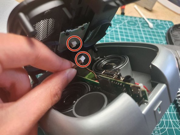

  4. Dual BT 10 Mainboard Disassembly, Disconnecting the components: crwdns2935265:04crwdnd2935265:01crwdnd2935265:02crwdne2935265:0 Dual BT 10 Mainboard Disassembly, Disconnecting the components: crwdns2935265:04crwdnd2935265:02crwdnd2935265:02crwdne2935265:0
    • Disconnect all cables:
    • Take a picture of how everything is plugged in to make reassembling easier
    • Disconnect the battery first (fat red/black cable, red socket)
    • Disconnect the two front speakers (blue/white cables)
    • Disconnect the Subwoofer and LED cable (brown/black, red/black cables)

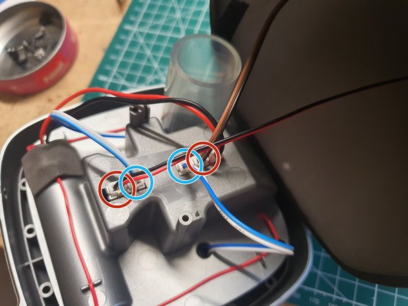

  5. Dual BT 10 Mainboard Disassembly, Removing the antenna wire: crwdns2935265:05crwdnd2935265:01crwdnd2935265:01crwdne2935265:0
    • Remove the red antenna wire by loosening it from the marked plastic taps

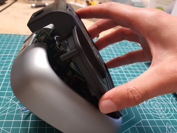

  6. Dual BT 10 Mainboard Disassembly, Unscrewing the front mesh: crwdns2935265:06crwdnd2935265:01crwdnd2935265:03crwdne2935265:0 Dual BT 10 Mainboard Disassembly, Unscrewing the front mesh: crwdns2935265:06crwdnd2935265:02crwdnd2935265:03crwdne2935265:0 Dual BT 10 Mainboard Disassembly, Unscrewing the front mesh: crwdns2935265:06crwdnd2935265:03crwdnd2935265:03crwdne2935265:0
    • Remove the four screws holding the front mesh
    • Separate the black plastic from the silver part
    • There is a cable connecting both parts! Be careful.
    • The mainboard is not screwed in place and will be loose after this step
    • Disconnect the brown cable from the small PCB to fully remove the black plastic
