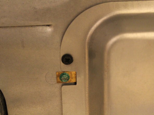

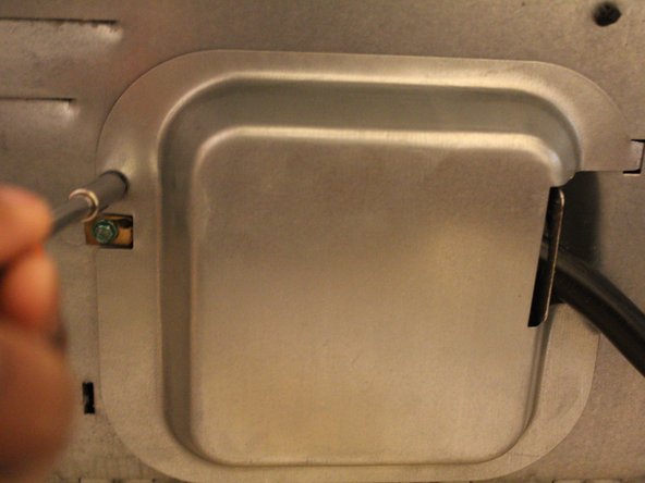

  2. Dryer Power Cord Replacement: crwdns2935265:02crwdnd2935265:01crwdnd2935265:03crwdne2935265:0 Dryer Power Cord Replacement: crwdns2935265:02crwdnd2935265:02crwdnd2935265:03crwdne2935265:0 Dryer Power Cord Replacement: crwdns2935265:02crwdnd2935265:03crwdnd2935265:03crwdne2935265:0

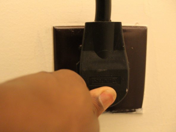

    • Unplug the dryer from the wall.
    • Use a screwdriver to remove any screws that secure the power cord cover.

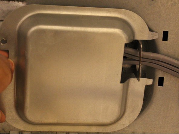

  3. Dryer Power Cord Replacement: crwdns2935265:03crwdnd2935265:01crwdnd2935265:02crwdne2935265:0 Dryer Power Cord Replacement: crwdns2935265:03crwdnd2935265:02crwdnd2935265:02crwdne2935265:0
    • Remove the panel by sliding it to the LEFT.

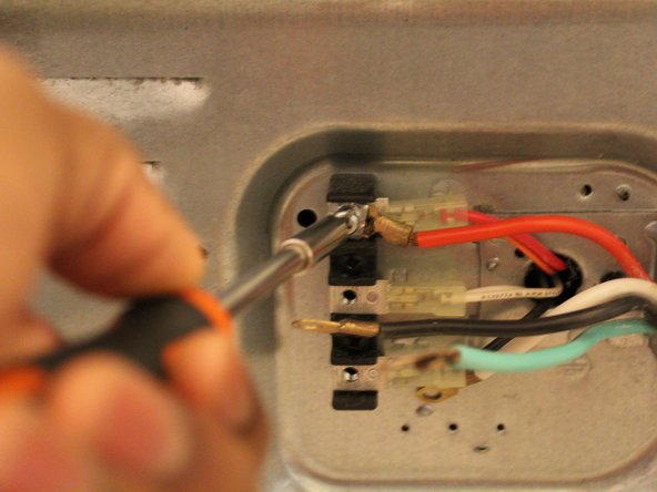

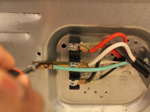

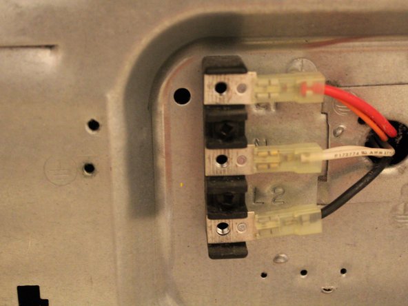

  4. Dryer Power Cord Replacement: crwdns2935265:04crwdnd2935265:01crwdnd2935265:01crwdne2935265:0
    • Now that the panel is off, you can see the wires needed to be replaced.
    • The configuration of the wires are power at the top (Usually represented as RED or BLACK)
    • The ground wire is in the middle (Usually represented as WHITE)
    • The bottom wire is also a power wire also (Usually represented as RED or BLACK)

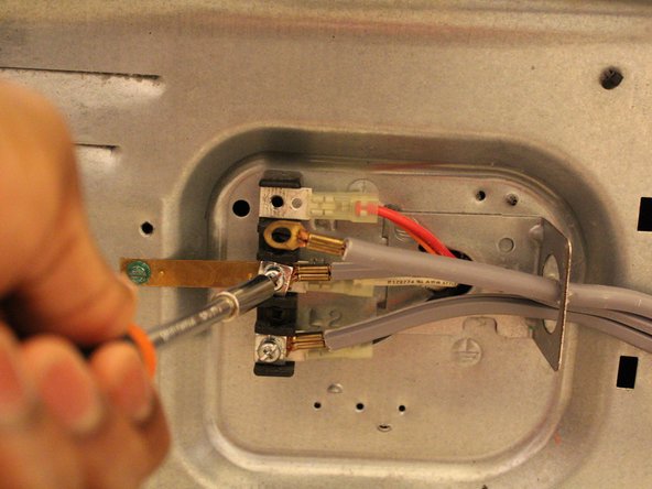

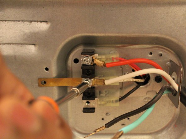

  5. Dryer Power Cord Replacement: crwdns2935265:05crwdnd2935265:01crwdnd2935265:03crwdne2935265:0 Dryer Power Cord Replacement: crwdns2935265:05crwdnd2935265:02crwdnd2935265:03crwdne2935265:0 Dryer Power Cord Replacement: crwdns2935265:05crwdnd2935265:03crwdnd2935265:03crwdne2935265:0
    • Remove the screws that hold the three wires in place.
  6. Dryer Power Cord Replacement: crwdns2935265:06crwdnd2935265:01crwdnd2935265:02crwdne2935265:0 Dryer Power Cord Replacement: crwdns2935265:06crwdnd2935265:02crwdnd2935265:02crwdne2935265:0
    • You should now be able to remove the power cord freely.

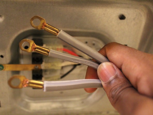

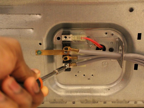

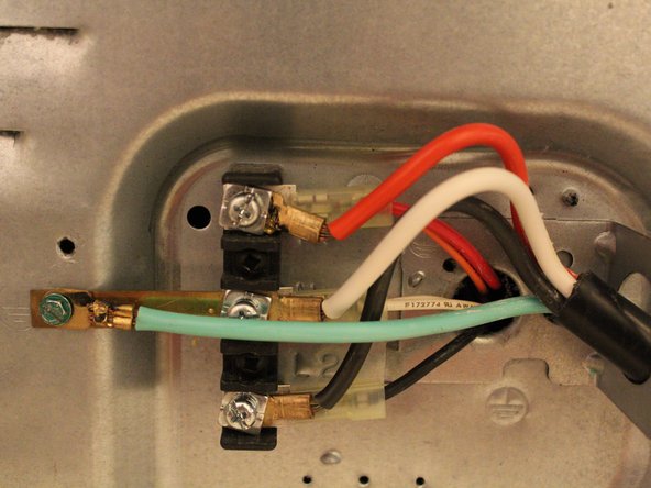

  8. Dryer Power Cord Replacement: crwdns2935265:08crwdnd2935265:01crwdnd2935265:03crwdne2935265:0 Dryer Power Cord Replacement: crwdns2935265:08crwdnd2935265:02crwdnd2935265:03crwdne2935265:0 Dryer Power Cord Replacement: crwdns2935265:08crwdnd2935265:03crwdnd2935265:03crwdne2935265:0
    • With everything removed, you can now bring in your new 4 prong power cord.
    • Unlike the old power cord, the new power cord should have the color of what type of wire it is (ex. red for power and white for ground).
    • You can start screwing in the wires with the removed screws from the old cord to the new RED WIRE at the TOP.
    • With the WHITE WIRE, grab the gold plate and put it on top of the wire. Grab the screw and put it on top of the gold plate and screw it in the MIDDLE.
  9. Dryer Power Cord Replacement: crwdns2935265:09crwdnd2935265:01crwdnd2935265:03crwdne2935265:0 Dryer Power Cord Replacement: crwdns2935265:09crwdnd2935265:02crwdnd2935265:03crwdne2935265:0 Dryer Power Cord Replacement: crwdns2935265:09crwdnd2935265:03crwdnd2935265:03crwdne2935265:0
    • Screw the BLACK WIRE at the BOTTOM regularly like the red wire.
    • You should have an extra green wire as this is placed where you saw the green screw in the beginning.
    • Grab the green wire and put it at the end of the gold plate and grab the green screw to screw it in for a tight connection.
