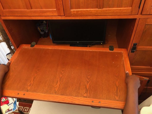

    • Place the drop front panel on a firm and flat surface.
    • A firm surface minimizes the risk of the panel injuring one’s body or experiencing further damages.

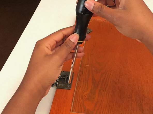

  2. Drop-Front Desk Panel Repair: crwdns2935265:02crwdnd2935265:01crwdnd2935265:03crwdne2935265:0 Drop-Front Desk Panel Repair: crwdns2935265:02crwdnd2935265:02crwdnd2935265:03crwdne2935265:0 Drop-Front Desk Panel Repair: crwdns2935265:02crwdnd2935265:03crwdnd2935265:03crwdne2935265:0
    • Position the rectangular plate over the Phillips #5 wood screw holes (15mm) on the left width.
    • There are six Phillips #5 wooden screw holes in total (15mm). Four wooden screw holes (15mm) are on the left width of the panel and two other screw holes are on the width's side.
    • Repeat this step with the right width of the panel.

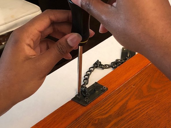

    • The rectangular plates that will later be fastened to the left and right width are connected to chains. The chains connect to another hinge piece that will later be connected to the main desk frame.
  3. Drop-Front Desk Panel Repair: crwdns2935265:03crwdnd2935265:01crwdnd2935265:03crwdne2935265:0 Drop-Front Desk Panel Repair: crwdns2935265:03crwdnd2935265:02crwdnd2935265:03crwdne2935265:0 Drop-Front Desk Panel Repair: crwdns2935265:03crwdnd2935265:03crwdnd2935265:03crwdne2935265:0
    • Use the Phillips #2 screwdriver to turn the six Phillips #5 wood screws (15 mm) and secure the rectangular plates to the left width of the panel.
    • Turn the screwdriver to the right to tighten the screws. Turn the screwdriver to the left to loosen the screws.

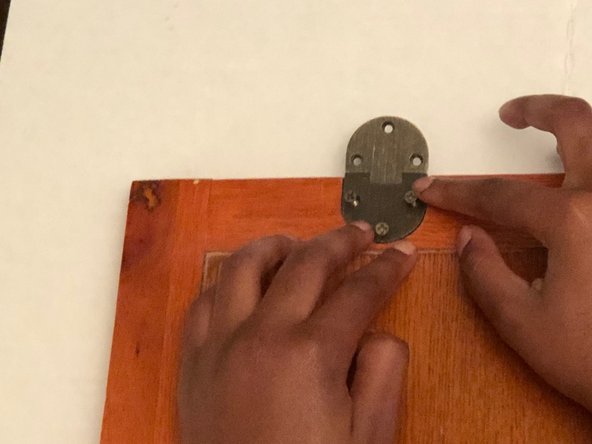

  4. Drop-Front Desk Panel Repair: crwdns2935265:04crwdnd2935265:01crwdnd2935265:03crwdne2935265:0 Drop-Front Desk Panel Repair: crwdns2935265:04crwdnd2935265:02crwdnd2935265:03crwdne2935265:0 Drop-Front Desk Panel Repair: crwdns2935265:04crwdnd2935265:03crwdnd2935265:03crwdne2935265:0
    • Position the hemispherical plates over the left hemispherical hole on the length of the panel.
    • Repeat this step with the right length of the panel.
    • A hemisphere is the half of a circle.
    • Use the Phillips #2 screwdriver to turn the three #5 wood screws (15mm) and tighten the hemispherical plates along the length of the drop-front panel.

    • Prevent dropping the drop-front panel by carrying the panel with each hand grasping both sides of the panel's width.
    • Carry the panel from the flat surface to the main desk frame.
  6. Drop-Front Desk Panel Repair: crwdns2935265:06crwdnd2935265:01crwdnd2935265:03crwdne2935265:0 Drop-Front Desk Panel Repair: crwdns2935265:06crwdnd2935265:02crwdnd2935265:03crwdne2935265:0 Drop-Front Desk Panel Repair: crwdns2935265:06crwdnd2935265:03crwdnd2935265:03crwdne2935265:0
    • Connect the panel to the bottom edge of the main desk frame.
  7. Drop-Front Desk Panel Repair: crwdns2935265:07crwdnd2935265:01crwdnd2935265:02crwdne2935265:0 Drop-Front Desk Panel Repair: crwdns2935265:07crwdnd2935265:02crwdnd2935265:02crwdne2935265:0
    • Position the panel's hemispherical plates over the hemispherical holes on the left and right side of the main desk frame.
  8. Drop-Front Desk Panel Repair: crwdns2935265:08crwdnd2935265:01crwdnd2935265:03crwdne2935265:0 Drop-Front Desk Panel Repair: crwdns2935265:08crwdnd2935265:02crwdnd2935265:03crwdne2935265:0 Drop-Front Desk Panel Repair: crwdns2935265:08crwdnd2935265:03crwdnd2935265:03crwdne2935265:0
    • Have one person hold the drop-front panel in place and another person screw the hinges in place.
    • Use the Phillips #2 screwdriver to turn the three Phillips #5 wood screws (15mm) and tighten the hemispherical hinges on the main desk frame.
