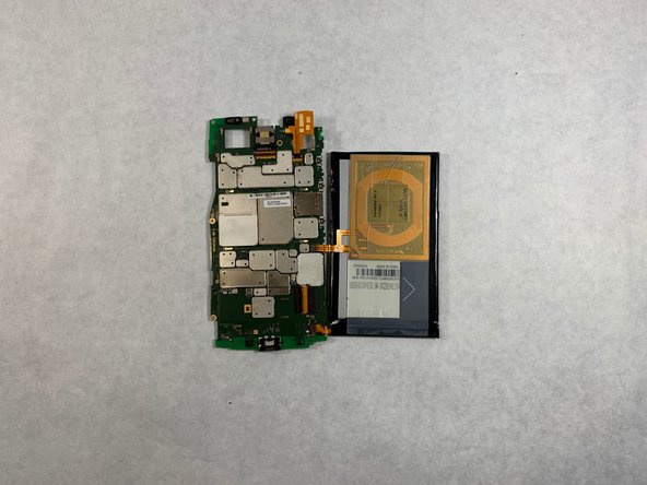

    • Remove the four T5 Torx screws securing the motherboard.
  6. Droid Ultra XT1080 Screen Replacement: crwdns2935265:06crwdnd2935265:01crwdnd2935265:01crwdne2935265:0
    • Gently pry the motherboard out of the frame using the plastic opening tool.
  7. Droid Ultra XT1080 Screen Replacement: crwdns2935265:07crwdnd2935265:01crwdnd2935265:02crwdne2935265:0 Droid Ultra XT1080 Screen Replacement: crwdns2935265:07crwdnd2935265:02crwdnd2935265:02crwdne2935265:0
    • Once motherboard is removed you have successfully removed the screen from the device.
