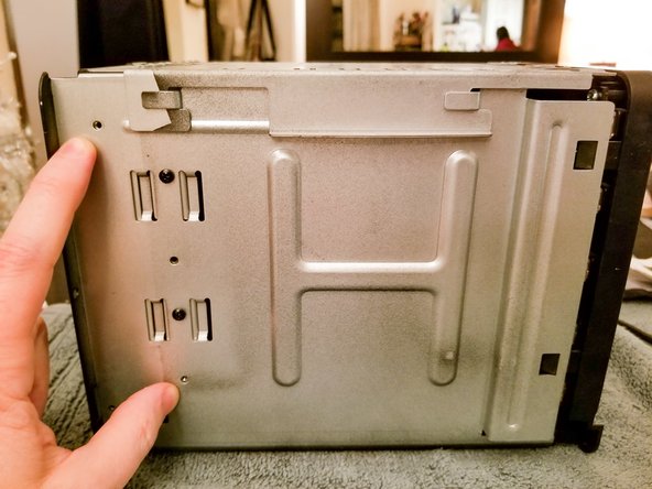

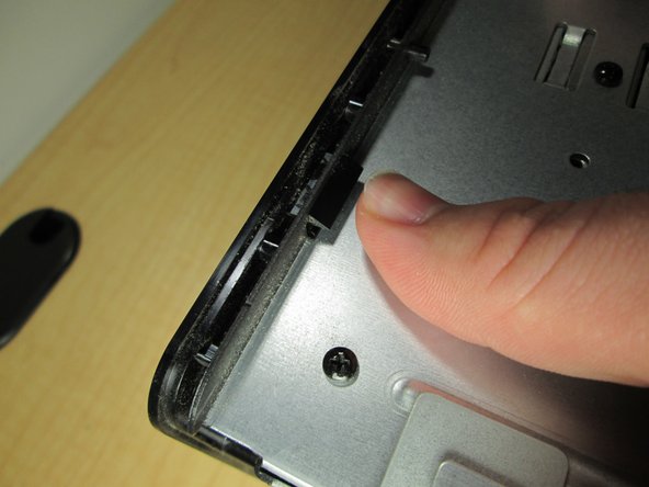

    • Next remove the screws from the feet of the case with a phillips head screwdriver.
  3. Drobo FS DRDS2-A Fan Replacement: crwdns2935265:03crwdnd2935265:01crwdnd2935265:01crwdne2935265:0
    • To remove the case, place the Drobo on its back and slide the case off.

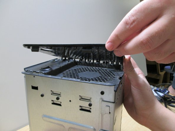

    • With case removed push tabs on back cover to remove the back cover. You can do this with your fingers or a tool such as a spudger.

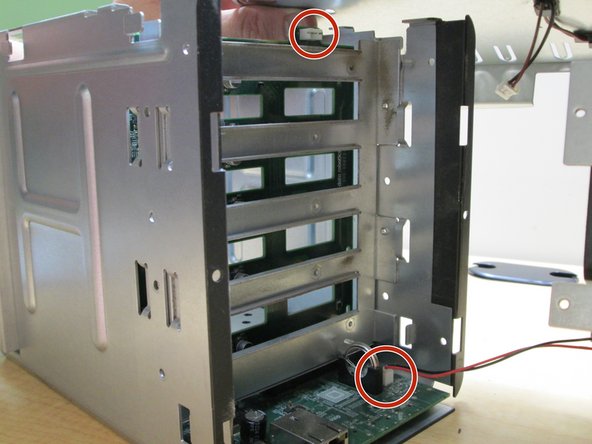

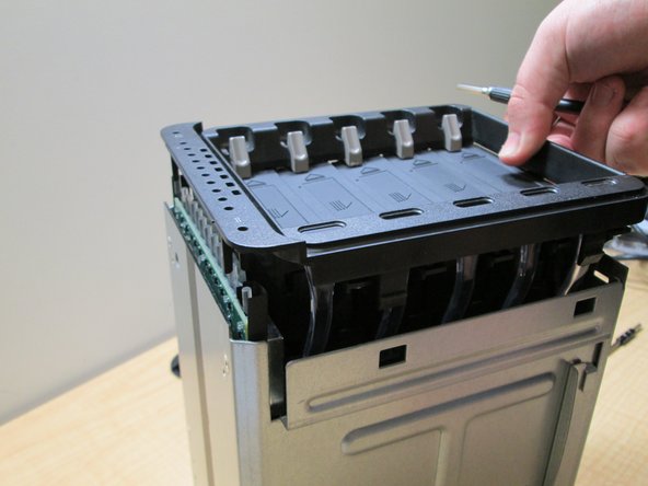

    • Then do the same to the other side, pushing the pins down. Then slide the hard drive docks out.
  6. Drobo FS DRDS2-A Fan Replacement: crwdns2935265:06crwdnd2935265:01crwdnd2935265:03crwdne2935265:0 Drobo FS DRDS2-A Fan Replacement: crwdns2935265:06crwdnd2935265:02crwdnd2935265:03crwdne2935265:0 Drobo FS DRDS2-A Fan Replacement: crwdns2935265:06crwdnd2935265:03crwdnd2935265:03crwdne2935265:0
    • Now slide the metal pieces away from each other to move past the hooks and then off carefully. As the two pieces separate be sure to carefully unplug the two wires to not cause any damage to the device.

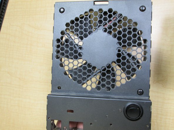

  7. Drobo FS DRDS2-A Fan Replacement: crwdns2935265:07crwdnd2935265:01crwdnd2935265:03crwdne2935265:0 Drobo FS DRDS2-A Fan Replacement: crwdns2935265:07crwdnd2935265:02crwdnd2935265:03crwdne2935265:0 Drobo FS DRDS2-A Fan Replacement: crwdns2935265:07crwdnd2935265:03crwdnd2935265:03crwdne2935265:0

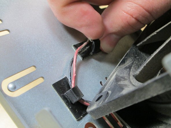

    • Next remove the fan by placing your screwdriver through the holes so that you can push out the small rivets. Then unclasp the wires so that you can finally remove the fan.
  8. Drobo FS DRDS2-A Fan Replacement: crwdns2935265:08crwdnd2935265:01crwdnd2935265:01crwdne2935265:0
    • Now replace the fan. Be careful to put it in the same way that it was taken out. Then re-clasp on the wire.

What size fan is there in the Drobo FS?
rogerschooneveld - crwdns2934203:0crwdne2934203:0
What are the dimensions of the fan needed? I would like to order the fan before disassembling.
Bill Lumbergh - crwdns2934203:0crwdne2934203:0
120mm 3 pin - I used the Noctua NF-A12x15 FLX. I had to use the screws that came with it instead of the original fixings as they didn’t fit the new fan. Also had to cut off the cable and solder the original one on as the connector is different. Red to red, black to black (and slide head shrink tubing over the join and then shrunk it by holding over steam from the kettle.
Jon - crwdns2934203:0crwdne2934203:0
On my 5D I had to replace the rivets with 1 1/4 inch machine screws with loctite nuts. The rivets were so damaged in the removal that they would not hold the fan in place. Also, check after assembling the rear into place that the new cable is clear of the fan. I got the exact replacement fan from DigiKey - Part: 259-1472-ND SUNON FAN MEC0251V3-000U-A99 12VDC. It was like $25 including shipping.
The replacement fan came with bare leads so I had to splice the old connector on with solder and shrink tube. be careful to keep the leads the same length because longer leads will cause a problem in the tight clearance in front of the fan.
