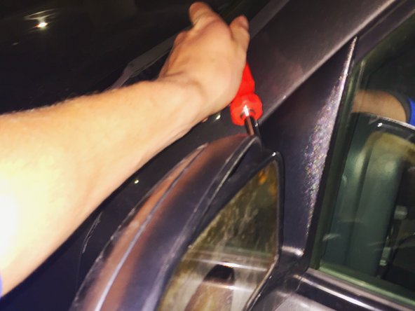

    • Turn the mirror in towards the vehicle allowing access to the left side of the mirror.
    • This can be done either electronically from the inside of the vehicle or manually by applying force to the mirror.
  2. Driver Side Mirror Replacement on 2002 Chevrolet Tahoe: crwdns2935265:02crwdnd2935265:01crwdnd2935265:01crwdne2935265:0
    • Insert the screwdriver on the left side of the mirror and apply force to release.

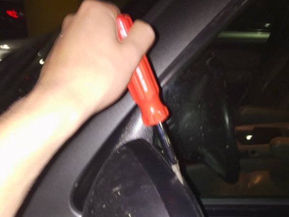

  3. Driver Side Mirror Replacement on 2002 Chevrolet Tahoe: crwdns2935265:03crwdnd2935265:01crwdnd2935265:03crwdne2935265:0 Driver Side Mirror Replacement on 2002 Chevrolet Tahoe: crwdns2935265:03crwdnd2935265:02crwdnd2935265:03crwdne2935265:0 Driver Side Mirror Replacement on 2002 Chevrolet Tahoe: crwdns2935265:03crwdnd2935265:03crwdnd2935265:03crwdne2935265:0
    • Insert the screwdriver on the top of the mirror and apply force to release this section.
    • Repeat this step for the bottom portion along with the ride side of the mirror.

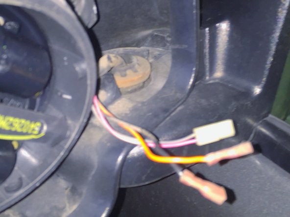

    • Unclip all three wires and remove the old mirror from the module.
To reassemble your new mirror, follow these instructions in reverse order.
