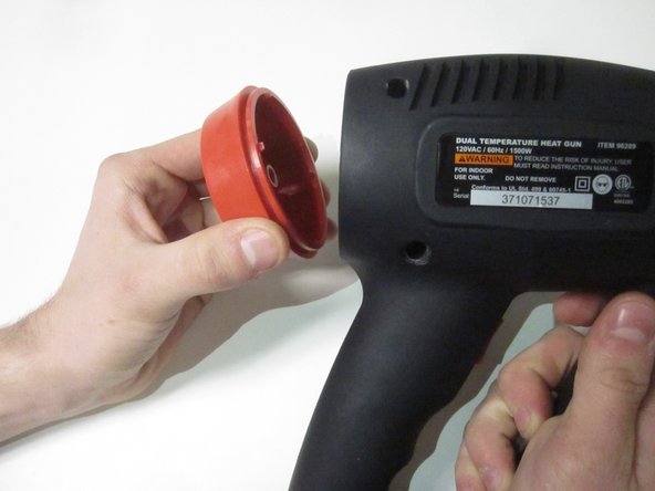

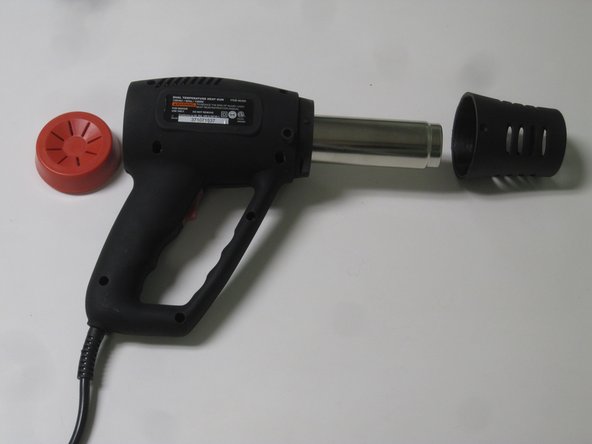

    • Remove the barrel casing on either end by twisting and pulling each side off.

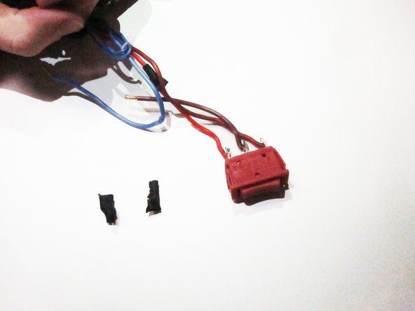

    • Remove the black, plastic wire protectors from the end of the power switch.
  8. Drill Master Heat Gun Power Switch Replacement: crwdns2935265:08crwdnd2935265:01crwdnd2935265:01crwdne2935265:0
    • Use soldering iron to remove the electrical wiring from the power switch. To replace the power switch, solder the new switch onto the wires.
    • Heating the soldering metal will allow you to pull off the electrical wiring.
