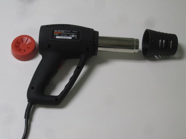

    • Remove the 8mm screw from underside of barrel using the PH#0 screwdriver.
    • Don't try to open the casing just yet.
  3. Drill Master Heat Gun Power Cord Replacement: crwdns2935265:03crwdnd2935265:01crwdnd2935265:03crwdne2935265:0 Drill Master Heat Gun Power Cord Replacement: crwdns2935265:03crwdnd2935265:02crwdnd2935265:03crwdne2935265:0 Drill Master Heat Gun Power Cord Replacement: crwdns2935265:03crwdnd2935265:03crwdnd2935265:03crwdne2935265:0
    • Remove the barrel casing on either end by twisting and pulling each side off.
  4. Drill Master Heat Gun Power Cord Replacement: crwdns2935265:04crwdnd2935265:01crwdnd2935265:01crwdne2935265:0
    • Remove the top casing to reveal inside of drill. You might have to tug a little harder for this one.
