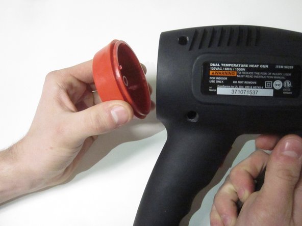

    • Be sure the heat gun is unplugged before starting this process.
    • Remove the seven 14mm screws from the side of the drill using the PH#0 screwdriver.
    • You will need a screwdriver extension.
  2. Drill Master Heat Gun Fan Replacement: crwdns2935265:02crwdnd2935265:01crwdnd2935265:01crwdne2935265:0
    • Remove the 8mm screw from underside of barrel using the PH#0 screwdriver.
    • Don't try to open the casing just yet.

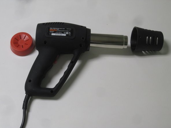

  3. Drill Master Heat Gun Fan Replacement: crwdns2935265:03crwdnd2935265:01crwdnd2935265:03crwdne2935265:0 Drill Master Heat Gun Fan Replacement: crwdns2935265:03crwdnd2935265:02crwdnd2935265:03crwdne2935265:0 Drill Master Heat Gun Fan Replacement: crwdns2935265:03crwdnd2935265:03crwdnd2935265:03crwdne2935265:0
    • Remove the barrel casing on either end by twisting and pulling each side off.
