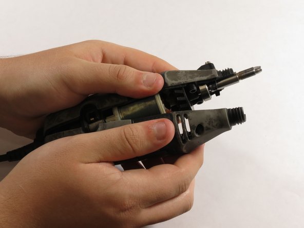

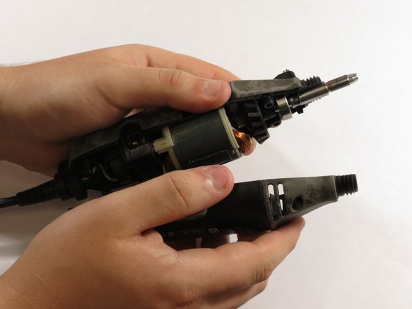

    • Pull the bottom side of the casing up to remove it.
  8. Dremel MultiPro 395 On/Off Switch Replacement: crwdns2935265:08crwdnd2935265:01crwdnd2935265:03crwdne2935265:0 Dremel MultiPro 395 On/Off Switch Replacement: crwdns2935265:08crwdnd2935265:02crwdnd2935265:03crwdne2935265:0 Dremel MultiPro 395 On/Off Switch Replacement: crwdns2935265:08crwdnd2935265:03crwdnd2935265:03crwdne2935265:0
    • Gently lift the motor shaft out of the Multipro.

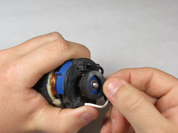

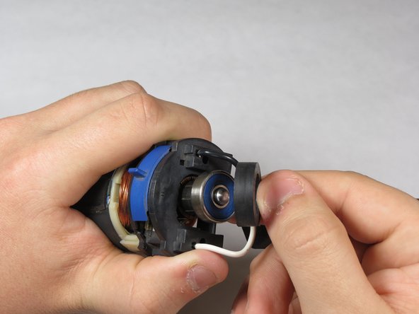

    • Remove the rubber ring from the bottom of the armature.
