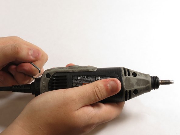

    • Pull one side of the hanger up and then pull away from the Multipro until the other side can be pulled out.
  4. Dremel MultiPro 395 Casing Replacement: crwdns2935265:04crwdnd2935265:01crwdnd2935265:03crwdne2935265:0 Dremel MultiPro 395 Casing Replacement: crwdns2935265:04crwdnd2935265:02crwdnd2935265:03crwdne2935265:0 Dremel MultiPro 395 Casing Replacement: crwdns2935265:04crwdnd2935265:03crwdnd2935265:03crwdne2935265:0

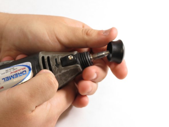

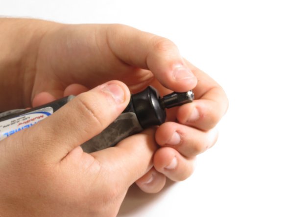

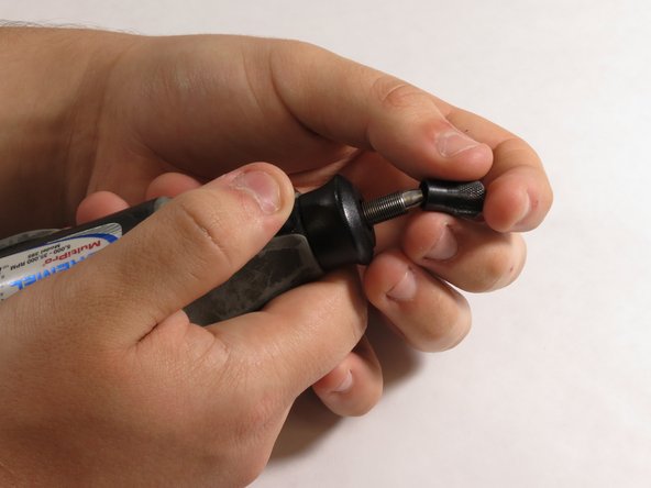

    • Hold down the collet lock, remove the chuck cap from the top of the Multipro by screwing counterclockwise.
  6. Dremel MultiPro 395 Casing Replacement: crwdns2935265:06crwdnd2935265:01crwdnd2935265:03crwdne2935265:0 Dremel MultiPro 395 Casing Replacement: crwdns2935265:06crwdnd2935265:02crwdnd2935265:03crwdne2935265:0 Dremel MultiPro 395 Casing Replacement: crwdns2935265:06crwdnd2935265:03crwdnd2935265:03crwdne2935265:0

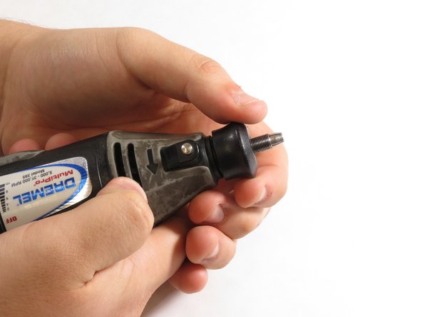

    • Remove the black housing cap from the Multipro located directly below the chuck cap.
  7. Dremel MultiPro 395 Casing Replacement: crwdns2935265:07crwdnd2935265:01crwdnd2935265:03crwdne2935265:0 Dremel MultiPro 395 Casing Replacement: crwdns2935265:07crwdnd2935265:02crwdnd2935265:03crwdne2935265:0 Dremel MultiPro 395 Casing Replacement: crwdns2935265:07crwdnd2935265:03crwdnd2935265:03crwdne2935265:0

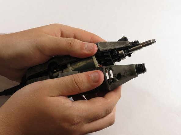

    • Pull the bottom side of the casing up to remove it.
  8. Dremel MultiPro 395 Casing Replacement: crwdns2935265:08crwdnd2935265:01crwdnd2935265:03crwdne2935265:0 Dremel MultiPro 395 Casing Replacement: crwdns2935265:08crwdnd2935265:02crwdnd2935265:03crwdne2935265:0 Dremel MultiPro 395 Casing Replacement: crwdns2935265:08crwdnd2935265:03crwdnd2935265:03crwdne2935265:0

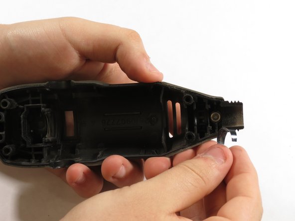

    • Gently lift the motor shaft out of the Multipro.
  9. Dremel MultiPro 395 Casing Replacement: crwdns2935265:09crwdnd2935265:01crwdnd2935265:03crwdne2935265:0 Dremel MultiPro 395 Casing Replacement: crwdns2935265:09crwdnd2935265:02crwdnd2935265:03crwdne2935265:0 Dremel MultiPro 395 Casing Replacement: crwdns2935265:09crwdnd2935265:03crwdnd2935265:03crwdne2935265:0
    • Pull the lock pin and its casing out of the other side of the Multipro case.
