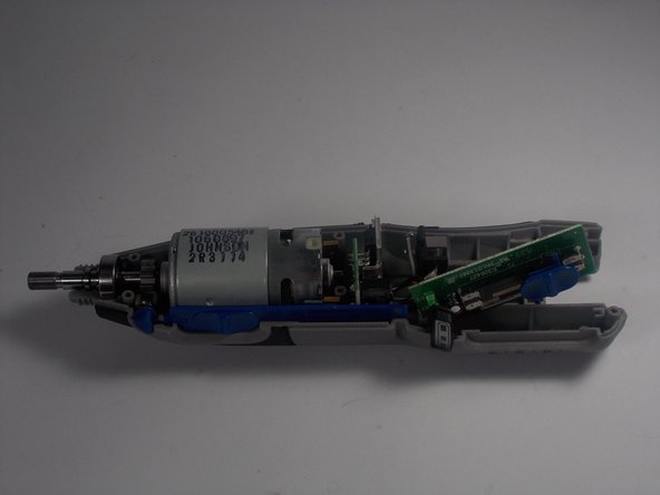

This guide will show you an easy, no skill required method of replacing your Dremel's speed selector switch. If your device will not change head speed when you move the switch then this guide is for you! Using only one tool your device will be working in just a few minutes.

      • Remove the 5 torx screws using a t9 screwdriver head.
      • Now pull apart the plastic shell of the device. If you are not able to, review the previous steps as you may have missed one.
    6. Dremel 8220 Speed Selector Switch Replacement: crwdns2935265:06crwdnd2935265:01crwdnd2935265:01crwdne2935265:0
      • The speed selector switch is now easily accessible. Grab the switch and lift it out of the circuit board.
