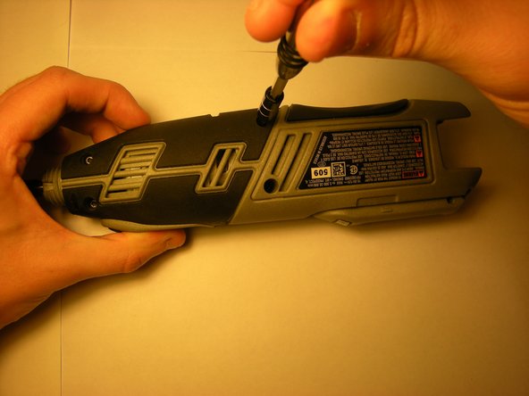

    5. Dremel 8220 Power Switch Replacement: crwdns2935265:05crwdnd2935265:01crwdnd2935265:03crwdne2935265:0 Dremel 8220 Power Switch Replacement: crwdns2935265:05crwdnd2935265:02crwdnd2935265:03crwdne2935265:0 Dremel 8220 Power Switch Replacement: crwdns2935265:05crwdnd2935265:03crwdnd2935265:03crwdne2935265:0
      • Remove five T9 Torx screws from the side of the tool.
      • Now pull apart the plastic shell of the device. If you are not able to, review the previous steps as you may have missed one.

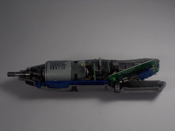

    6. Dremel 8220 Power Switch Replacement: crwdns2935265:06crwdnd2935265:01crwdnd2935265:01crwdne2935265:0
      • Remove the faulty power switch. It should come out of the device without using any force.
