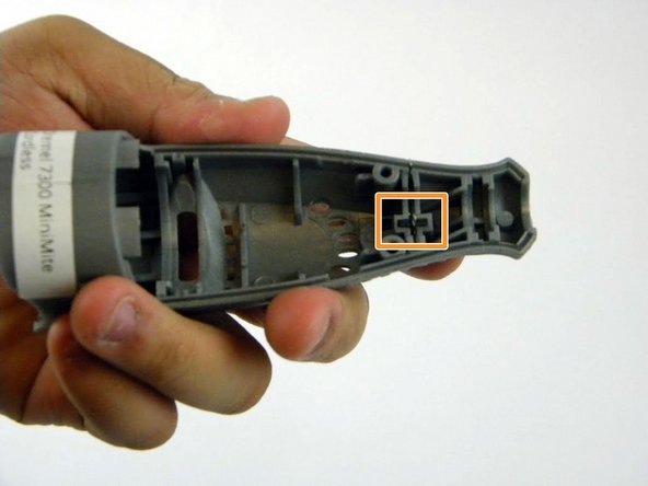

  6. Dremel 7300 MiniMite Cordless Shaft Lock Assembly Replacement: crwdns2935265:06crwdnd2935265:01crwdnd2935265:03crwdne2935265:0 Dremel 7300 MiniMite Cordless Shaft Lock Assembly Replacement: crwdns2935265:06crwdnd2935265:02crwdnd2935265:03crwdne2935265:0 Dremel 7300 MiniMite Cordless Shaft Lock Assembly Replacement: crwdns2935265:06crwdnd2935265:03crwdnd2935265:03crwdne2935265:0
    • Remove the wire ring from the device.
    • The wire ring may have come out when the motor-shaft assembly was removed.
    • Remove the key from its slot.
  7. Dremel 7300 MiniMite Cordless Shaft Lock Assembly Replacement: crwdns2935265:07crwdnd2935265:01crwdnd2935265:02crwdne2935265:0 Dremel 7300 MiniMite Cordless Shaft Lock Assembly Replacement: crwdns2935265:07crwdnd2935265:02crwdnd2935265:02crwdne2935265:0
    • Ensure that the shaft lock assembly fits together properly when reassembling the device.
    • The notch in the wire ring should fit on the key as pictured.
