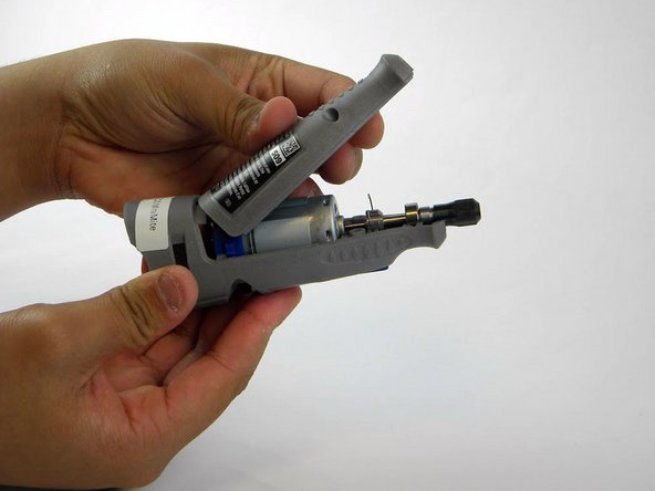

  3. Dremel 7300 MiniMite Cordless Motor-Shaft Assembly Replacement: crwdns2935265:03crwdnd2935265:01crwdnd2935265:03crwdne2935265:0 Dremel 7300 MiniMite Cordless Motor-Shaft Assembly Replacement: crwdns2935265:03crwdnd2935265:02crwdnd2935265:03crwdne2935265:0 Dremel 7300 MiniMite Cordless Motor-Shaft Assembly Replacement: crwdns2935265:03crwdnd2935265:03crwdnd2935265:03crwdne2935265:0
    • Lift off the unscrewed plastic cover at an angle, away from the tip of the device.
    • Gently lift the cover. It won't take much force to remove it.

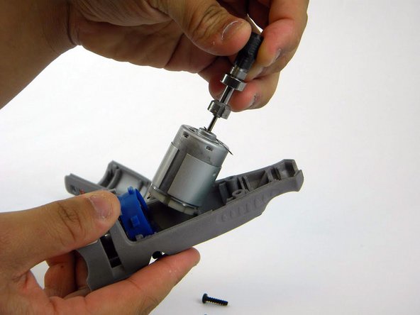

  4. Dremel 7300 MiniMite Cordless Motor-Shaft Assembly Replacement: crwdns2935265:04crwdnd2935265:01crwdnd2935265:03crwdne2935265:0 Dremel 7300 MiniMite Cordless Motor-Shaft Assembly Replacement: crwdns2935265:04crwdnd2935265:02crwdnd2935265:03crwdne2935265:0 Dremel 7300 MiniMite Cordless Motor-Shaft Assembly Replacement: crwdns2935265:04crwdnd2935265:03crwdnd2935265:03crwdne2935265:0
    • Lift the tip of the motor-shaft assembly gently, then pull the assembly out.
    • The blue battery contact and the spring for the shaft lock button may pop out when you remove the motor-shaft assembly. Make sure to keep track of these pieces, as they are very small.

Ok the blue part the battery connection battery to motor. Popped out and I put back but it's not making connection to motor or battery. I tried spinning for different angles but nothing has helped. Motor still good and battery still has charge. It's just connection between the two. All parts still together. What am I doin wrong
