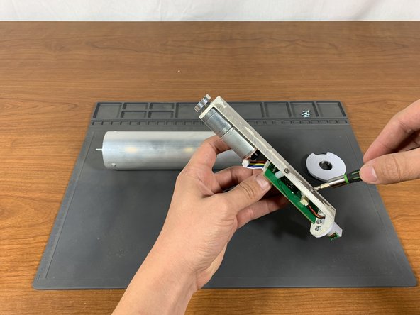

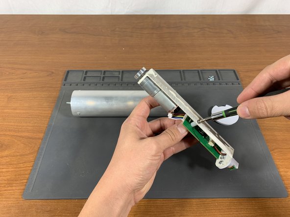

  3. Dreamer Autoshade Driver Blocking, Loosen PCB mounting Screws: crwdns2935265:03crwdnd2935265:01crwdnd2935265:03crwdne2935265:0 Dreamer Autoshade Driver Blocking, Loosen PCB mounting Screws: crwdns2935265:03crwdnd2935265:02crwdnd2935265:03crwdne2935265:0 Dreamer Autoshade Driver Blocking, Loosen PCB mounting Screws: crwdns2935265:03crwdnd2935265:03crwdnd2935265:03crwdne2935265:0
    • Use a #1 Phillips head screwdriver to loosen the PCB mounting screws until the circuit board can be adjusted. This should only take 1-2 full rotations of the screwdriver. Do not fully remove the screws.
