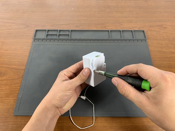

  1. Dreamer Autoshade Battery Box Reset, Remove holding screws: crwdns2935265:01crwdnd2935265:01crwdnd2935265:03crwdne2935265:0 Dreamer Autoshade Battery Box Reset, Remove holding screws: crwdns2935265:01crwdnd2935265:02crwdnd2935265:03crwdne2935265:0 Dreamer Autoshade Battery Box Reset, Remove holding screws: crwdns2935265:01crwdnd2935265:03crwdnd2935265:03crwdne2935265:0
    • Remove the two Phillips plastic threading screws with a #1 Phillips head screwdriver.
  2. Dreamer Autoshade Battery Box Reset, Disconnect battery pack connector: crwdns2935265:02crwdnd2935265:01crwdnd2935265:02crwdne2935265:0 Dreamer Autoshade Battery Box Reset, Disconnect battery pack connector: crwdns2935265:02crwdnd2935265:02crwdnd2935265:02crwdne2935265:0
    • Disconnect the battery pack connector.
  3. Dreamer Autoshade Battery Box Reset, Reconnect the battery pack connector: crwdns2935265:03crwdnd2935265:01crwdnd2935265:01crwdne2935265:0
    • After a few seconds, reconnect the battery pack to the circuit board.
  4. Dreamer Autoshade Battery Box Reset, Close and secure the battery box: crwdns2935265:04crwdnd2935265:01crwdnd2935265:02crwdne2935265:0 Dreamer Autoshade Battery Box Reset, Close and secure the battery box: crwdns2935265:04crwdnd2935265:02crwdnd2935265:02crwdne2935265:0
    • Hold the battery box together and insert one screw. Try tightening the screw. If the screw does not tighten, remove the screw and insert it again. The screw must be inserted straight to catch the threaded hole.
    • Repeat the above step for the second screw.
