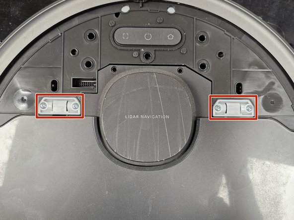

  1. Dreame Z10 Pro: Laser Distance Sensor Replacement, Remove the front half of the top cover: crwdns2935265:01crwdnd2935265:01crwdnd2935265:03crwdne2935265:0 Dreame Z10 Pro: Laser Distance Sensor Replacement, Remove the front half of the top cover: crwdns2935265:01crwdnd2935265:02crwdnd2935265:03crwdne2935265:0 Dreame Z10 Pro: Laser Distance Sensor Replacement, Remove the front half of the top cover: crwdns2935265:01crwdnd2935265:03crwdnd2935265:03crwdne2935265:0
    • Grab it, then give it a firm tug.
    • The latches here are pretty tight.

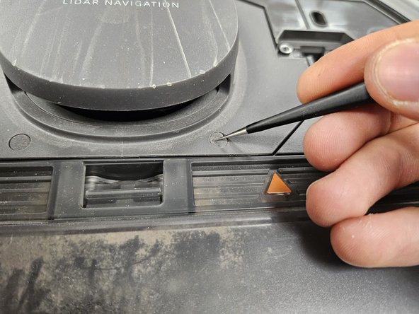

  2. Dreame Z10 Pro: Laser Distance Sensor Replacement, Remove the back half of the top cover: crwdns2935265:02crwdnd2935265:01crwdnd2935265:02crwdne2935265:0 Dreame Z10 Pro: Laser Distance Sensor Replacement, Remove the back half of the top cover: crwdns2935265:02crwdnd2935265:02crwdnd2935265:02crwdne2935265:0
    • Remove the screws using a PH2 screwdriver, then the plastic tabs.
    • Then remove the back half of the top cover.

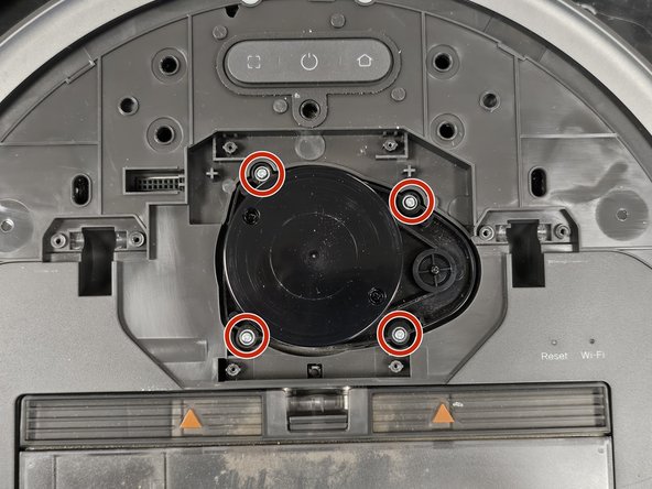

  3. Dreame Z10 Pro: Laser Distance Sensor Replacement, Remove the LDS cage: crwdns2935265:03crwdnd2935265:01crwdnd2935265:03crwdne2935265:0 Dreame Z10 Pro: Laser Distance Sensor Replacement, Remove the LDS cage: crwdns2935265:03crwdnd2935265:02crwdnd2935265:03crwdne2935265:0 Dreame Z10 Pro: Laser Distance Sensor Replacement, Remove the LDS cage: crwdns2935265:03crwdnd2935265:03crwdnd2935265:03crwdne2935265:0
    • Remove the rubber caps covering the screws.
    • Remove the screws. Use a PH00 screwdriver.

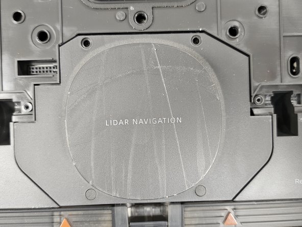

  4. Dreame Z10 Pro: Laser Distance Sensor Replacement, Remove the LDS: crwdns2935265:04crwdnd2935265:01crwdnd2935265:02crwdne2935265:0 Dreame Z10 Pro: Laser Distance Sensor Replacement, Remove the LDS: crwdns2935265:04crwdnd2935265:02crwdnd2935265:02crwdne2935265:0
    • Try not to lose these springs.
    • Remove the screws. Use a PH1 screwdriver.

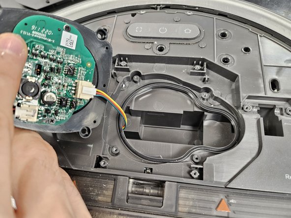

  5. Dreame Z10 Pro: Laser Distance Sensor Replacement, Remove the LDS and replace it: crwdns2935265:05crwdnd2935265:01crwdnd2935265:03crwdne2935265:0 Dreame Z10 Pro: Laser Distance Sensor Replacement, Remove the LDS and replace it: crwdns2935265:05crwdnd2935265:02crwdnd2935265:03crwdne2935265:0 Dreame Z10 Pro: Laser Distance Sensor Replacement, Remove the LDS and replace it: crwdns2935265:05crwdnd2935265:03crwdnd2935265:03crwdne2935265:0
    • Take the LDS out and disconnect the connector.
    • Insert a new LDS in and close it up.
