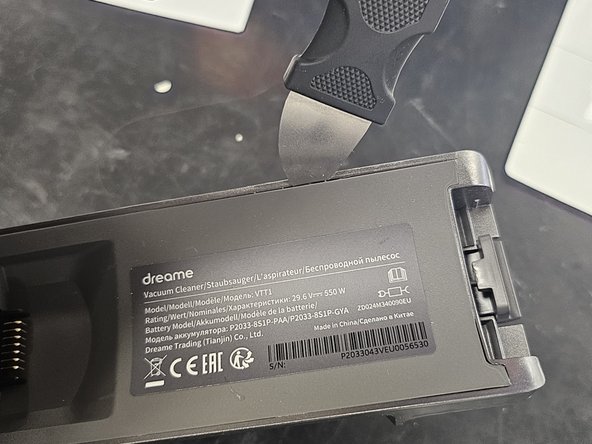

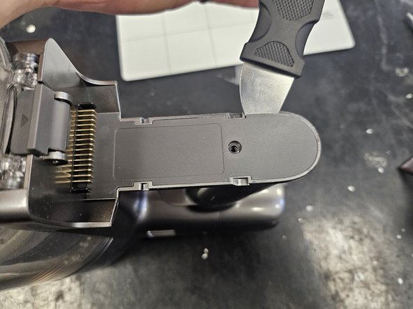

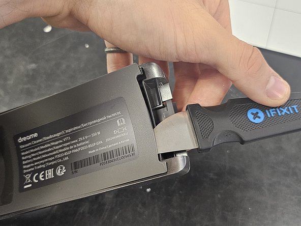

  2. Dreame T30: Teardown, Remove the bottom lid.: crwdns2935265:02crwdnd2935265:01crwdnd2935265:03crwdne2935265:0 Dreame T30: Teardown, Remove the bottom lid.: crwdns2935265:02crwdnd2935265:02crwdnd2935265:03crwdne2935265:0 Dreame T30: Teardown, Remove the bottom lid.: crwdns2935265:02crwdnd2935265:03crwdnd2935265:03crwdne2935265:0
    • Use a T10 torx screwdriver to remove the screw.
    • Then use a prying tool of some sort (Jimmy) to loosen the latches.
    • Finally, remove it.

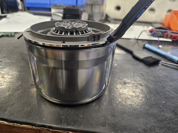

  3. Dreame T30: Teardown, Remove the dustbin.: crwdns2935265:03crwdnd2935265:01crwdnd2935265:02crwdne2935265:0 Dreame T30: Teardown, Remove the dustbin.: crwdns2935265:03crwdnd2935265:02crwdnd2935265:02crwdne2935265:0
    • Push the tab.
    • Pull it off.

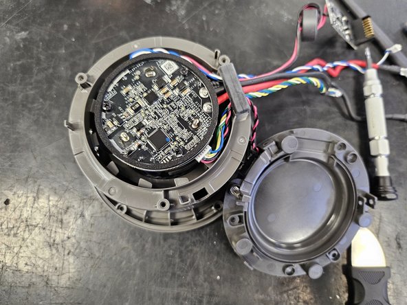

  4. Dreame T30: Teardown, Remove the inner lid: crwdns2935265:04crwdnd2935265:01crwdnd2935265:03crwdne2935265:0 Dreame T30: Teardown, Remove the inner lid: crwdns2935265:04crwdnd2935265:02crwdnd2935265:03crwdne2935265:0 Dreame T30: Teardown, Remove the inner lid: crwdns2935265:04crwdnd2935265:03crwdnd2935265:03crwdne2935265:0
    • It is only latched on.
    • Use a prying tool to force a gap.

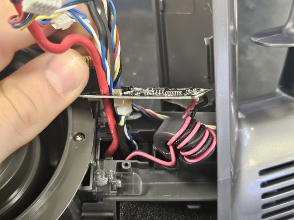

  5. Dreame T30: Teardown, Remove the cables from the PCBA: crwdns2935265:05crwdnd2935265:01crwdnd2935265:03crwdne2935265:0 Dreame T30: Teardown, Remove the cables from the PCBA: crwdns2935265:05crwdnd2935265:02crwdnd2935265:03crwdne2935265:0 Dreame T30: Teardown, Remove the cables from the PCBA: crwdns2935265:05crwdnd2935265:03crwdnd2935265:03crwdne2935265:0

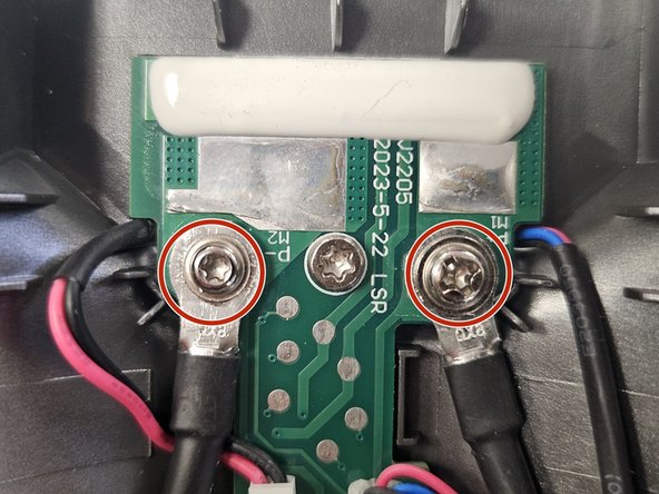

    • Remove the positive and negative leads of the suction fan from the pcba.
    • Negative is T8 Torx, positive is PH2.

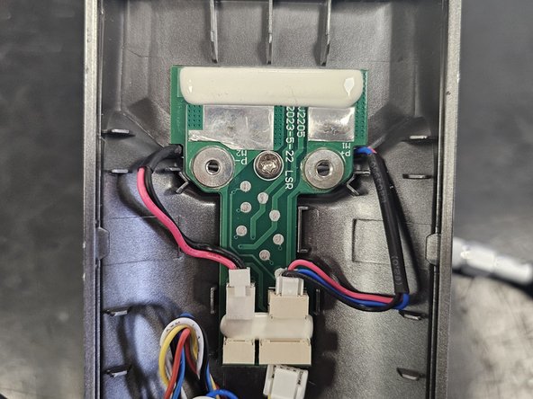

  6. Dreame T30: Teardown, Remove the cables from the PCBA: crwdns2935265:06crwdnd2935265:01crwdnd2935265:02crwdne2935265:0 Dreame T30: Teardown, Remove the cables from the PCBA: crwdns2935265:06crwdnd2935265:02crwdnd2935265:02crwdne2935265:0
    • Disconnect the rest of the cables and remove the middle screw.
    • It is a T10 Torx.
    • Once the screw is removed, push the PCBA out. Simply push on the battery connector.

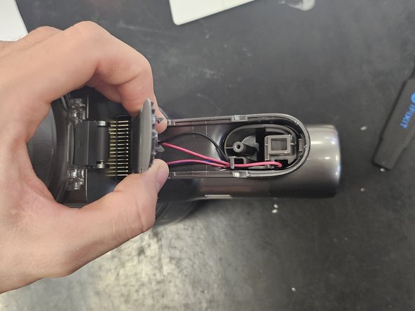

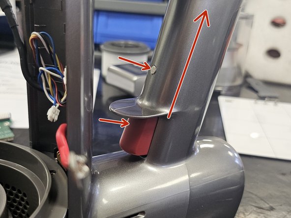

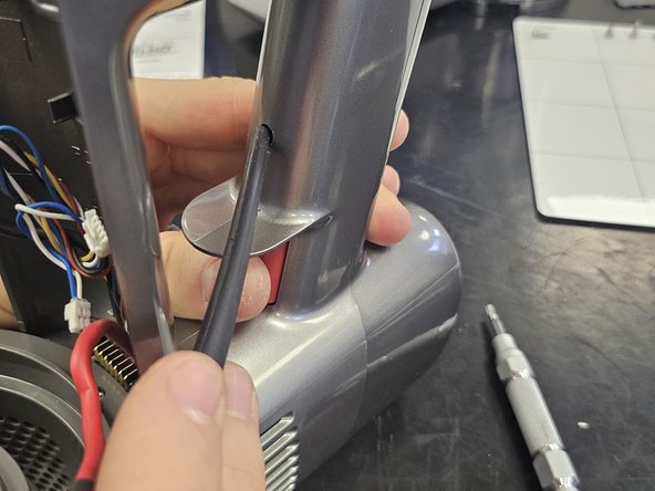

  7. Dreame T30: Teardown, Removing the handle: crwdns2935265:07crwdnd2935265:01crwdnd2935265:03crwdne2935265:0 Dreame T30: Teardown, Removing the handle: crwdns2935265:07crwdnd2935265:02crwdnd2935265:03crwdne2935265:0 Dreame T30: Teardown, Removing the handle: crwdns2935265:07crwdnd2935265:03crwdnd2935265:03crwdne2935265:0
    • Back up top, pull the 2 top wires through the gap.
    • You will now have to push the little grey button and the red trigger button in while applying some upwards pressure to loosen the handle.

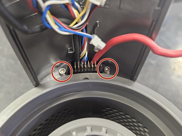

  8. Dreame T30: Teardown, Removing the handle: crwdns2935265:08crwdnd2935265:01crwdnd2935265:02crwdne2935265:0 Dreame T30: Teardown, Removing the handle: crwdns2935265:08crwdnd2935265:02crwdnd2935265:02crwdne2935265:0
    • Now, simply pull the handle out.
    • Rotate back to the front and remove the 2 marked screws. They're T10 Torx.

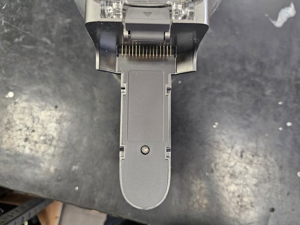

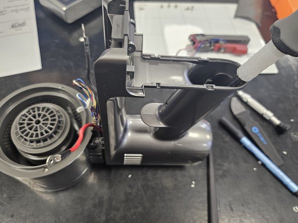

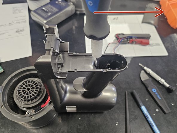

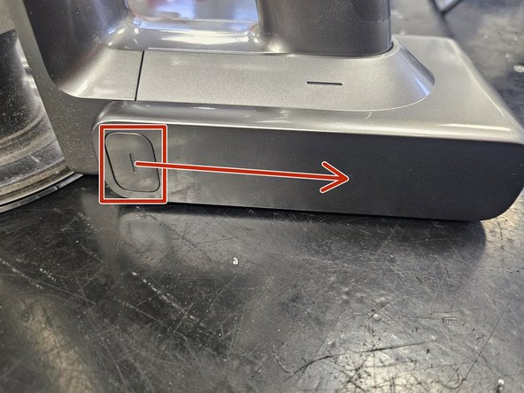

  10. Dreame T30: Teardown, Removing the handle chassis: crwdns2935265:010crwdnd2935265:01crwdnd2935265:03crwdne2935265:0 Dreame T30: Teardown, Removing the handle chassis: crwdns2935265:010crwdnd2935265:02crwdnd2935265:03crwdne2935265:0 Dreame T30: Teardown, Removing the handle chassis: crwdns2935265:010crwdnd2935265:03crwdnd2935265:03crwdne2935265:0
    • To remove the handle chassis, insert a prying tool into the marked gap.
    • Do not fit it into the bigger round hole to the left. Fit it into the hole on the right side, which is significantly tighter.
    • I use my looong Phillips screwdriver for this.
    • Then, simply apply adequate force in the direction of the arrow.

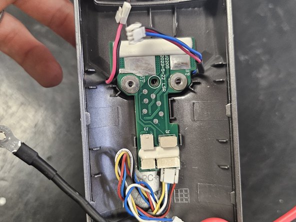

  11. Dreame T30: Teardown, Cables: crwdns2935265:011crwdnd2935265:01crwdnd2935265:02crwdne2935265:0 Dreame T30: Teardown, Cables: crwdns2935265:011crwdnd2935265:02crwdnd2935265:02crwdne2935265:0
    • Now, pull the chassis off, but only enough to expose the pcba and not any more.
    • Remove the small screw from the PCBA. It is a Torx T6.
    • Disconnect the cable from the PCBA, then pull the other cables through the gap in the PCBA.

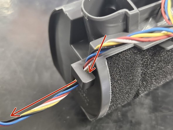

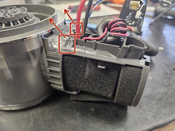

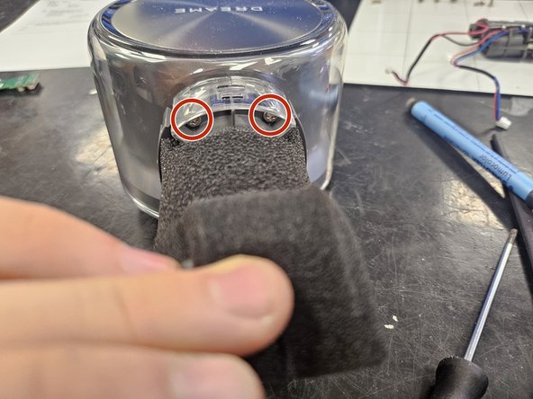

  13. Dreame T30: Teardown, Chassis part 3: crwdns2935265:013crwdnd2935265:01crwdnd2935265:03crwdne2935265:0 Dreame T30: Teardown, Chassis part 3: crwdns2935265:013crwdnd2935265:02crwdnd2935265:03crwdne2935265:0 Dreame T30: Teardown, Chassis part 3: crwdns2935265:013crwdnd2935265:03crwdnd2935265:03crwdne2935265:0
    • Remove the marked screws, then flip it over.
    • Unfold the foam filter out of the way, then remove the other 2 screws.
    • They're all Torx T10 screws.

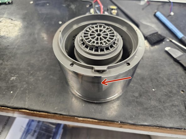

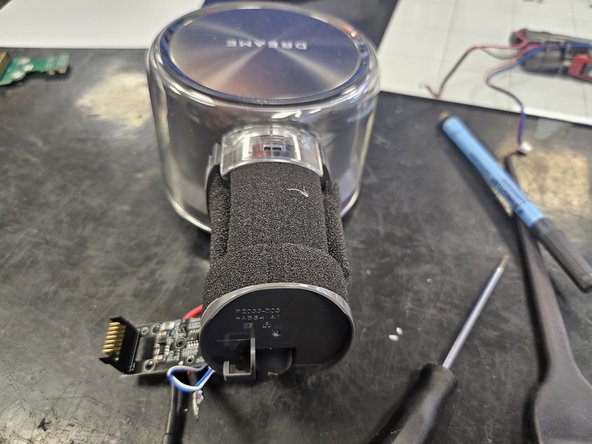

  14. Dreame T30: Teardown, Chassis part 14: crwdns2935265:014crwdnd2935265:01crwdnd2935265:02crwdne2935265:0 Dreame T30: Teardown, Chassis part 14: crwdns2935265:014crwdnd2935265:02crwdnd2935265:02crwdne2935265:0
    • Remove the chassis by bending the transparent plastic out of the way, and unlatching the latches.
    • Then pull it off.

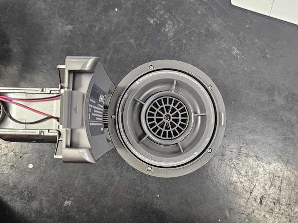

  15. Dreame T30: Teardown, Suction fan chassis: crwdns2935265:015crwdnd2935265:01crwdnd2935265:03crwdne2935265:0 Dreame T30: Teardown, Suction fan chassis: crwdns2935265:015crwdnd2935265:02crwdnd2935265:03crwdne2935265:0 Dreame T30: Teardown, Suction fan chassis: crwdns2935265:015crwdnd2935265:03crwdnd2935265:03crwdne2935265:0
    • Remove the 5 screws.
    • There is still a latch holding it together at the front. Use a prying tool to unlatch it.
  16. Dreame T30: Teardown, Suction fan assembly: crwdns2935265:016crwdnd2935265:01crwdnd2935265:02crwdne2935265:0 Dreame T30: Teardown, Suction fan assembly: crwdns2935265:016crwdnd2935265:02crwdnd2935265:02crwdne2935265:0
    • Once you remove the suction fan assembly, you can disassemble it by taking these 3 screws off.
    • Once you have it open, you can pull out the suction fan. Do note that is going to be hard to get out, as it's pretty firmly stuck in there.
    • Forcing the suction fan out runs a high chance of delidding it. I haven't noticed any performance drops after reattaching the lid back on, though.

Great thanks! My power button was stuck, with your guide I quickly took the handle apart and sanded down the power button around the top part (It looks like there was a small friction groove from use, which caught the power button from time to time). Now it's back together and working perfectly, great guide, thanks a lot stranger!
Albert Zweistein - crwdns2934203:0crwdne2934203:0
I also had to perform work on the power button. Steps 1-8 worked perfectly to get access on my T20 model - light sanding to the red power button, and some padding behind the button.
Todd Neaves - crwdns2934203:0crwdne2934203:0
