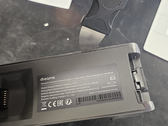

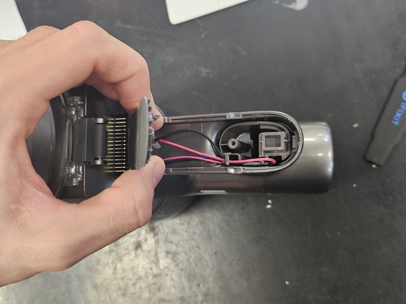

    • Begin by removing the removable battery.

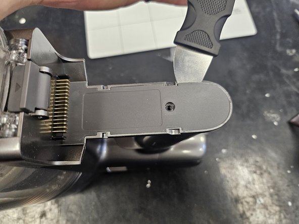

  2. Dreame T30: Display Replacement, Remove the bottom lid.: crwdns2935265:02crwdnd2935265:01crwdnd2935265:03crwdne2935265:0 Dreame T30: Display Replacement, Remove the bottom lid.: crwdns2935265:02crwdnd2935265:02crwdnd2935265:03crwdne2935265:0 Dreame T30: Display Replacement, Remove the bottom lid.: crwdns2935265:02crwdnd2935265:03crwdnd2935265:03crwdne2935265:0
    • Use a T10 torx screwdriver to remove the screw.
    • Then use a prying tool of some sort (Jimmy) to loosen the latches.
    • Finally, remove it.

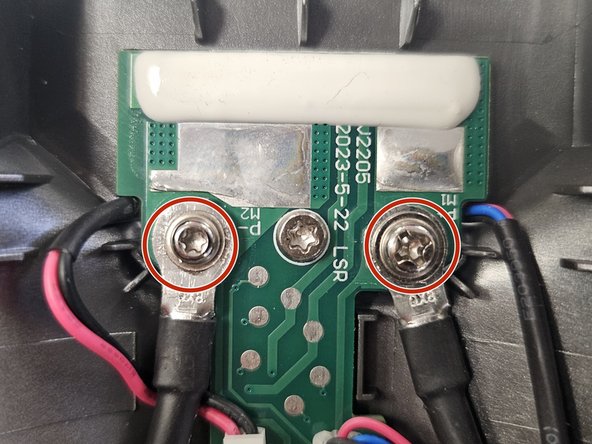

    • Remove the positive and negative leads of the suction fan from the pcba.
    • Negative is a T8 Torx, positive is PH2.

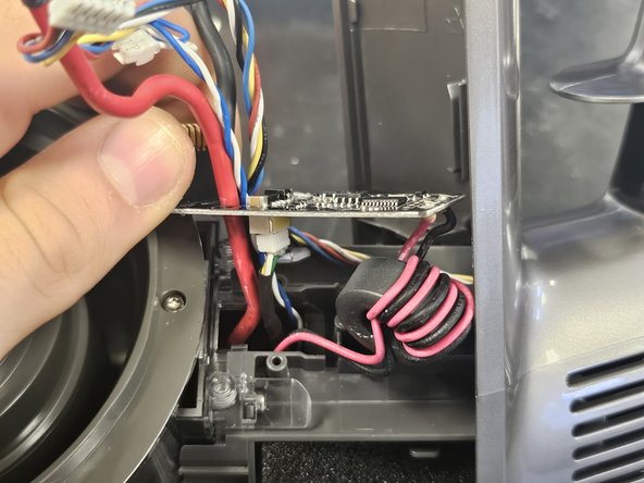

  6. Dreame T30: Display Replacement, Remove the cables from the PCBA: crwdns2935265:06crwdnd2935265:01crwdnd2935265:02crwdne2935265:0 Dreame T30: Display Replacement, Remove the cables from the PCBA: crwdns2935265:06crwdnd2935265:02crwdnd2935265:02crwdne2935265:0
    • Disconnect the rest of the cables and remove the middle screw.
    • It is a T10 Torx.
    • Once the screw is removed, push the PCBA out. Simply push on the battery connector.

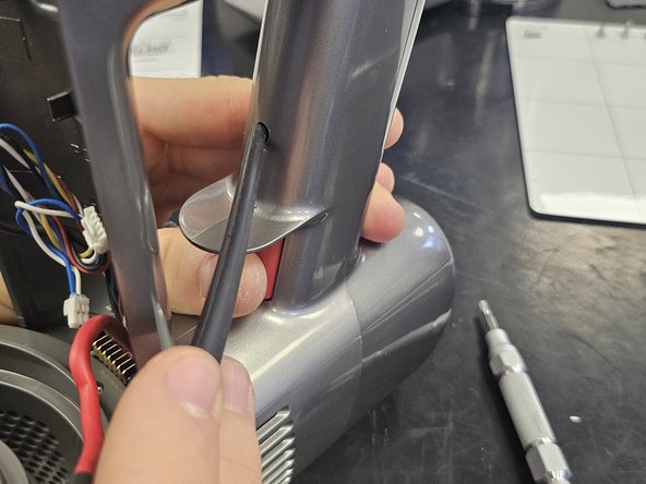

  7. Dreame T30: Display Replacement, Removing the handle: crwdns2935265:07crwdnd2935265:01crwdnd2935265:03crwdne2935265:0 Dreame T30: Display Replacement, Removing the handle: crwdns2935265:07crwdnd2935265:02crwdnd2935265:03crwdne2935265:0 Dreame T30: Display Replacement, Removing the handle: crwdns2935265:07crwdnd2935265:03crwdnd2935265:03crwdne2935265:0
    • Back up top, pull the 2 top wires through the gap.
    • You will now have to push the little grey button and the red trigger button in while applying some upwards pressure to loosen the handle.
  8. Dreame T30: Display Replacement, Removing the handle: crwdns2935265:08crwdnd2935265:01crwdnd2935265:02crwdne2935265:0 Dreame T30: Display Replacement, Removing the handle: crwdns2935265:08crwdnd2935265:02crwdnd2935265:02crwdne2935265:0
    • Now, simply pull the handle out.

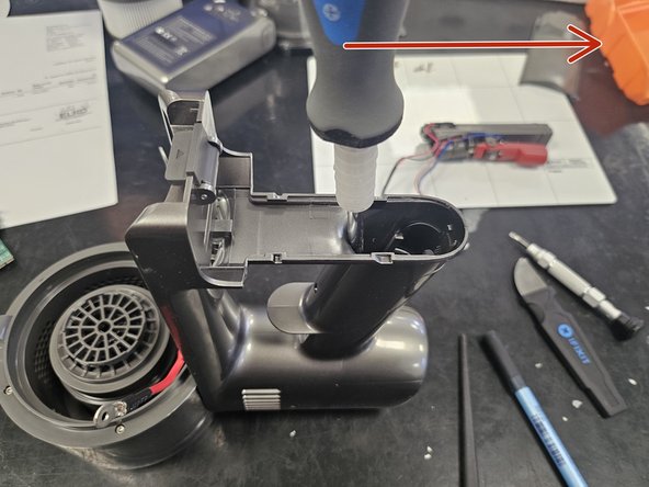

  9. Dreame T30: Display Replacement, Removing the handle chassis: crwdns2935265:09crwdnd2935265:01crwdnd2935265:03crwdne2935265:0 Dreame T30: Display Replacement, Removing the handle chassis: crwdns2935265:09crwdnd2935265:02crwdnd2935265:03crwdne2935265:0 Dreame T30: Display Replacement, Removing the handle chassis: crwdns2935265:09crwdnd2935265:03crwdnd2935265:03crwdne2935265:0
    • To remove the handle chassis, insert a prying tool into the marked gap.
    • Do not fit it into the bigger round hole to the left. Fit it into the hole on the right side, which is significantly tighter.
    • I use my looong Phillips screwdriver for this.
    • Then, simply apply adequate force in the direction of the arrow.

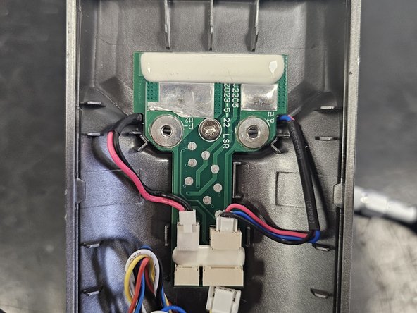

  10. Dreame T30: Display Replacement, Cables: crwdns2935265:010crwdnd2935265:01crwdnd2935265:02crwdne2935265:0 Dreame T30: Display Replacement, Cables: crwdns2935265:010crwdnd2935265:02crwdnd2935265:02crwdne2935265:0
    • Now, pull the chassis off, but only enough to expose the pcba and not any more.
    • Remove the small screw from the PCBA. It is a Torx T6.
    • Disconnect the cable from the PCBA, then pull the other cables through the gap in the PCBA.

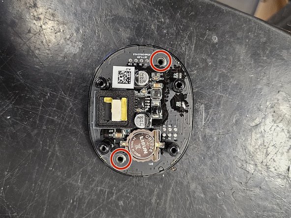

  12. Dreame T30: Display Replacement, Remove the display from the chassis: crwdns2935265:012crwdnd2935265:01crwdnd2935265:03crwdne2935265:0 Dreame T30: Display Replacement, Remove the display from the chassis: crwdns2935265:012crwdnd2935265:02crwdnd2935265:03crwdne2935265:0 Dreame T30: Display Replacement, Remove the display from the chassis: crwdns2935265:012crwdnd2935265:03crwdnd2935265:03crwdne2935265:0
    • Remove the marked screws.
    • They are Torx T10.
    • After removing the screws, push the display out. I usually just use the screwdriver to do so, as it is not held in by anything.
