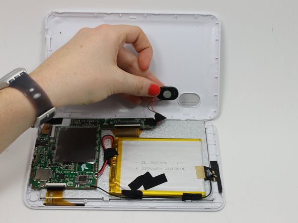

    • Position the tablet so the ports and screws are facing you.
  2. Dreamax DMX-ST7A Speaker Replacement: crwdns2935265:02crwdnd2935265:01crwdnd2935265:01crwdne2935265:0
    • Remove the two 2.5mm screws using the Phillips #00 precision screwdriver.
  3. Dreamax DMX-ST7A Speaker Replacement: crwdns2935265:03crwdnd2935265:01crwdnd2935265:02crwdne2935265:0 Dreamax DMX-ST7A Speaker Replacement: crwdns2935265:03crwdnd2935265:02crwdnd2935265:02crwdne2935265:0
    • Use the plastic opening tool to assist in removing the back cover.
  4. Dreamax DMX-ST7A Speaker Replacement: crwdns2935265:04crwdnd2935265:01crwdnd2935265:01crwdne2935265:0
    • Upon removing the back cover position the tablet as seen in the picture.
  5. Dreamax DMX-ST7A Speaker Replacement, Speaker: crwdns2935265:05crwdnd2935265:01crwdnd2935265:02crwdne2935265:0 Dreamax DMX-ST7A Speaker Replacement, Speaker: crwdns2935265:05crwdnd2935265:02crwdnd2935265:02crwdne2935265:0
    • Remove the speaker from the back cover.
  6. Dreamax DMX-ST7A Speaker Replacement: crwdns2935265:06crwdnd2935265:01crwdnd2935265:01crwdne2935265:0
    • Remove the black and red wire from the Motherboard.
