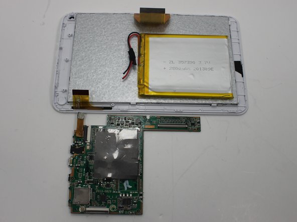

  7. Dreamax DMX-ST7A Motherboard Replacement: crwdns2935265:07crwdnd2935265:01crwdnd2935265:02crwdne2935265:0 Dreamax DMX-ST7A Motherboard Replacement: crwdns2935265:07crwdnd2935265:02crwdnd2935265:02crwdne2935265:0
    • Remove the three wires connected to the battery along with the speaker wires from the motherboard. Then remove the motherboard from the tablet.
  8. Dreamax DMX-ST7A Motherboard Replacement: crwdns2935265:08crwdnd2935265:01crwdnd2935265:02crwdne2935265:0 Dreamax DMX-ST7A Motherboard Replacement: crwdns2935265:08crwdnd2935265:02crwdnd2935265:02crwdne2935265:0
    • Install the new motherboard by soldering the speaker wires and the battery wires in their intended location. For additional soldering instructions please view this page: How To Solder and Desolder Connections
