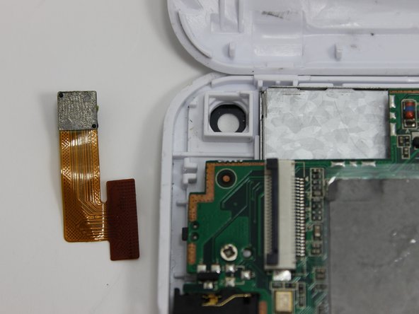

  3. Dreamax DMX-ST7A Camera Replacement: crwdns2935265:03crwdnd2935265:01crwdnd2935265:02crwdne2935265:0 Dreamax DMX-ST7A Camera Replacement: crwdns2935265:03crwdnd2935265:02crwdnd2935265:02crwdne2935265:0
    • Use the plastic opening tool to assist in removing the back cover.

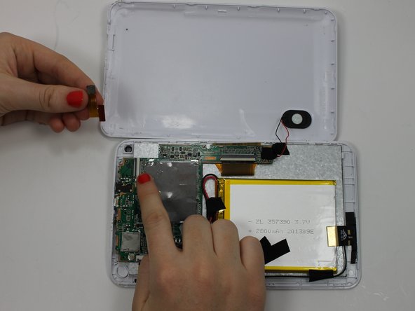

  4. Dreamax DMX-ST7A Camera Replacement: crwdns2935265:04crwdnd2935265:01crwdnd2935265:01crwdne2935265:0
    • Upon removing the back cover position the tablet as seen in the picture.

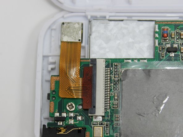

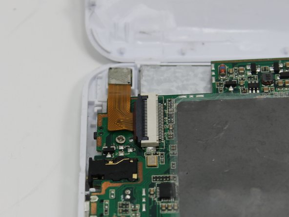

  5. Dreamax DMX-ST7A Camera Replacement, Camera: crwdns2935265:05crwdnd2935265:01crwdnd2935265:03crwdne2935265:0 Dreamax DMX-ST7A Camera Replacement, Camera: crwdns2935265:05crwdnd2935265:02crwdnd2935265:03crwdne2935265:0 Dreamax DMX-ST7A Camera Replacement, Camera: crwdns2935265:05crwdnd2935265:03crwdnd2935265:03crwdne2935265:0
    • Lift the black bar towards the right to expose the data strip.
  6. Dreamax DMX-ST7A Camera Replacement: crwdns2935265:06crwdnd2935265:01crwdnd2935265:03crwdne2935265:0 Dreamax DMX-ST7A Camera Replacement: crwdns2935265:06crwdnd2935265:02crwdnd2935265:03crwdne2935265:0 Dreamax DMX-ST7A Camera Replacement: crwdns2935265:06crwdnd2935265:03crwdnd2935265:03crwdne2935265:0
    • Remove the data strip and camera.
