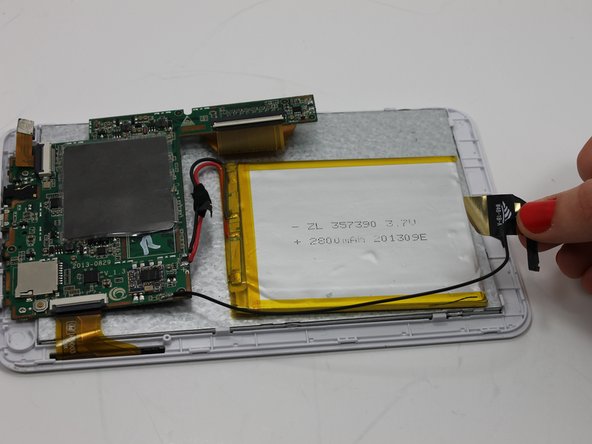

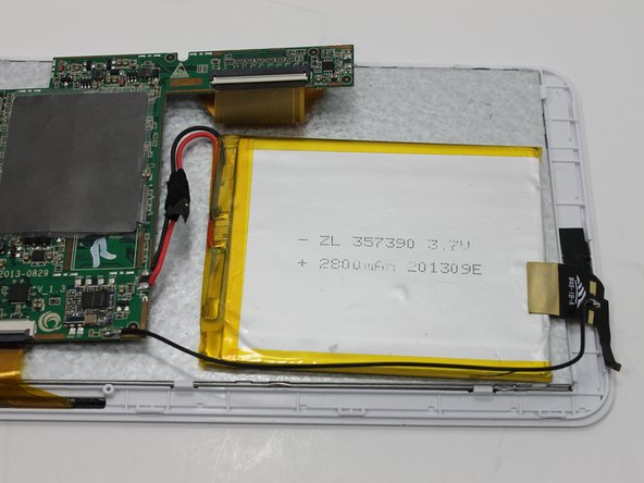

    • Remove any tape that might be holding the wires in place.

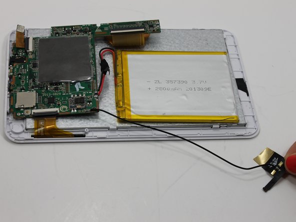

  6. Dreamax DMX-ST7A Battery Replacement: crwdns2935265:06crwdnd2935265:01crwdnd2935265:03crwdne2935265:0 Dreamax DMX-ST7A Battery Replacement: crwdns2935265:06crwdnd2935265:02crwdnd2935265:03crwdne2935265:0 Dreamax DMX-ST7A Battery Replacement: crwdns2935265:06crwdnd2935265:03crwdnd2935265:03crwdne2935265:0
    • Remove the black and gold tab connecting the battery to the tablet's frame.

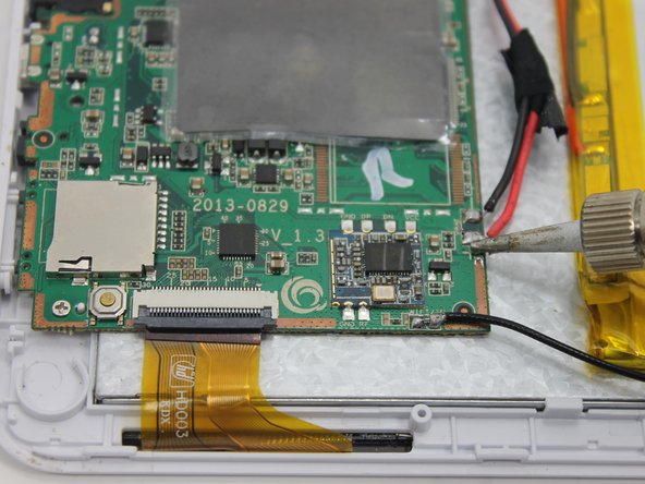

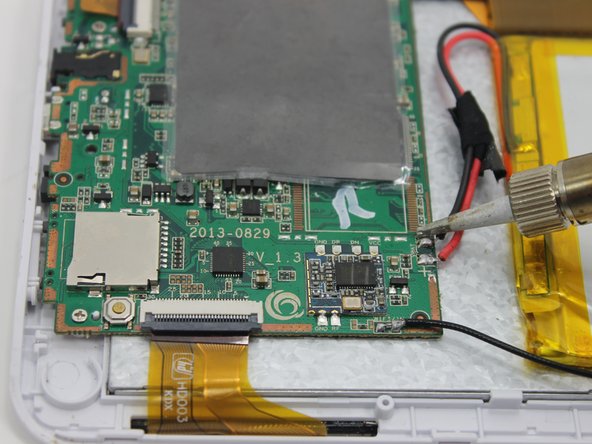

  7. Dreamax DMX-ST7A Battery Replacement: crwdns2935265:07crwdnd2935265:01crwdnd2935265:01crwdne2935265:0
    • Remove the the one red and two black wires that connect the battery to the motherboard.

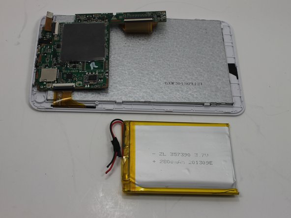

  8. Dreamax DMX-ST7A Battery Replacement: crwdns2935265:08crwdnd2935265:01crwdnd2935265:02crwdne2935265:0 Dreamax DMX-ST7A Battery Replacement: crwdns2935265:08crwdnd2935265:02crwdnd2935265:02crwdne2935265:0
    • Remove the battery from the tablet.
