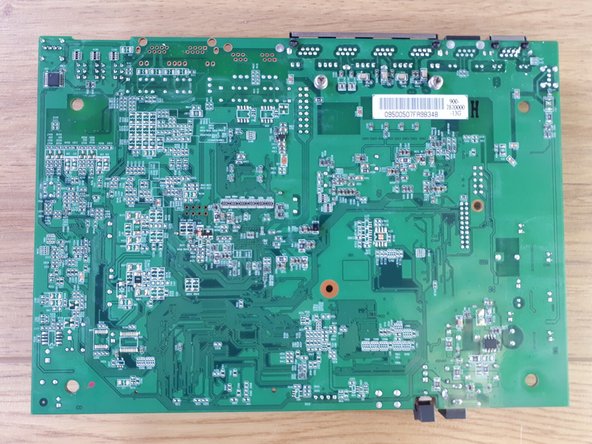

  3. DrayTek Vigor 2820 Teardown, remove the ADSL module: crwdns2935265:03crwdnd2935265:01crwdnd2935265:03crwdne2935265:0 DrayTek Vigor 2820 Teardown, remove the ADSL module: crwdns2935265:03crwdnd2935265:02crwdnd2935265:03crwdne2935265:0 DrayTek Vigor 2820 Teardown, remove the ADSL module: crwdns2935265:03crwdnd2935265:03crwdnd2935265:03crwdne2935265:0
    • Unscrew the screws attaching the ADSL module to the mainboard.
    • The mainboard:
    • Nanya Technology NT5DS16M16CS-5T 256Mb DDR SDRAM
    • Infineon Technologies PSB 6972 HL V1.2 Ethernet Switch Controller
    • Delta Electronics LFE8731
    • Delta Electronics LFE9208A
