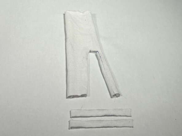

      • Using your pen and ruler, draw two strips of 3.5" x 0.5" pieces of cloth.
      • Cut those two strips with your scissors.

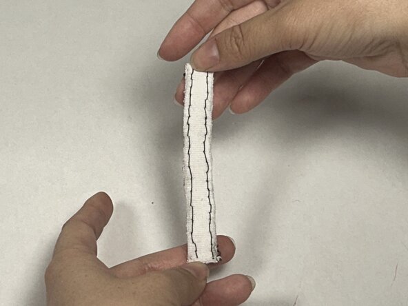

      • Align your two strips back to back.
      • Use two sewing pins to hold the strips in place for easy alignment during the sewing process.
      • Carefully handle the pins to avoid accidental punctures or injury. Use a thimble if needed.
    3. Drawstring Bag Tab Replacement: crwdns2935265:03crwdnd2935265:01crwdnd2935265:03crwdne2935265:0 Drawstring Bag Tab Replacement: crwdns2935265:03crwdnd2935265:02crwdnd2935265:03crwdne2935265:0 Drawstring Bag Tab Replacement: crwdns2935265:03crwdnd2935265:03crwdnd2935265:03crwdne2935265:0

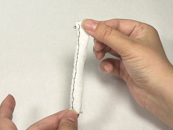

      • Using your thread and sewing needle, sew along the long edge in a straight line using a straight stitch.
      • Use a seam allowance of 1/8"
      • Repeat on the other side.
      • Carefully handle the needle to avoid accidental punctures or injury. Use a thimble if neede.

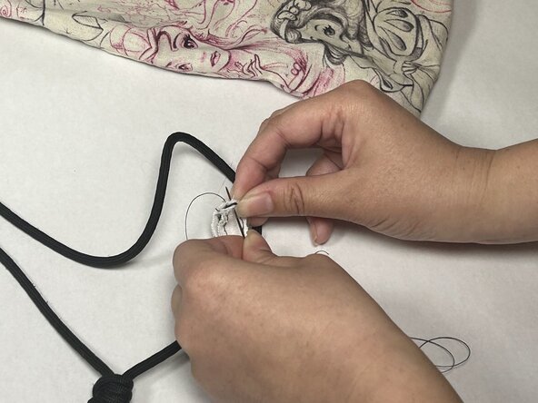

      • Fold your strip around the cord to your drawstring bag to create a loop.
    5. Drawstring Bag Tab Replacement: crwdns2935265:05crwdnd2935265:01crwdnd2935265:03crwdne2935265:0 Drawstring Bag Tab Replacement: crwdns2935265:05crwdnd2935265:02crwdnd2935265:03crwdne2935265:0 Drawstring Bag Tab Replacement: crwdns2935265:05crwdnd2935265:03crwdnd2935265:03crwdne2935265:0
      • Using the whipstitch technique, sew the two ends together.
      • Carefully handle the needle to avoid accidental punctures or injury. Use a thimble if needed.

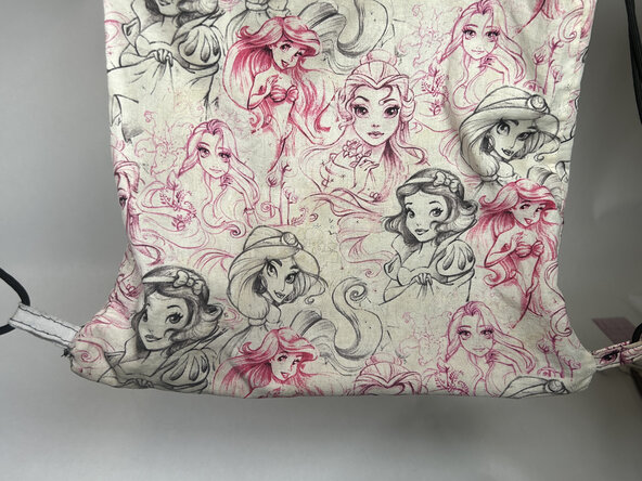

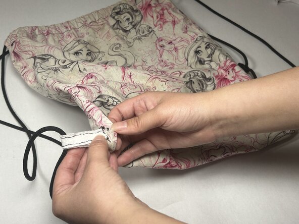

      • Take the sewn ends and insert them 1/4" into the ripped hole where the original tab was.
    7. Drawstring Bag Tab Replacement: crwdns2935265:07crwdnd2935265:01crwdnd2935265:03crwdne2935265:0 Drawstring Bag Tab Replacement: crwdns2935265:07crwdnd2935265:02crwdnd2935265:03crwdne2935265:0 Drawstring Bag Tab Replacement: crwdns2935265:07crwdnd2935265:03crwdnd2935265:03crwdne2935265:0
      • Align the fabric with the seam line.
      • Using the whipstitch technique, sew it to the bag from the outside ensuring the stitches are along the seam.
