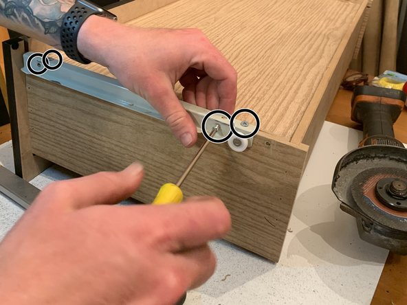

    • Remove the brackets on the drawer.
    • Some may have rivets, some may have screws. If there are screws a simple screwdriver will do the trick. If there are rivets use a drill the size of the head of the rivet and proceed to drill the head of the rivet.
    • When removing rivets with a drill, wear eye protection and be cautious.

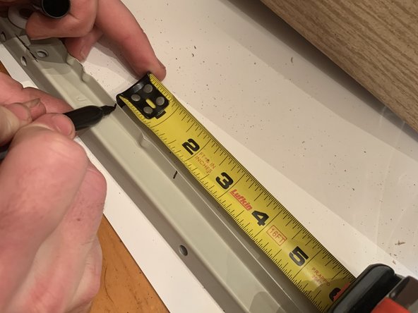

    • Measure the length of the internal track to the recessed part in the rear of the track.
    • This recess will hold the drawer completely closed when the wheel on the bracket reaches it.
    • Then measure the amount of bracket that needs to be removed. In our case, 2 inches will need to be removed.

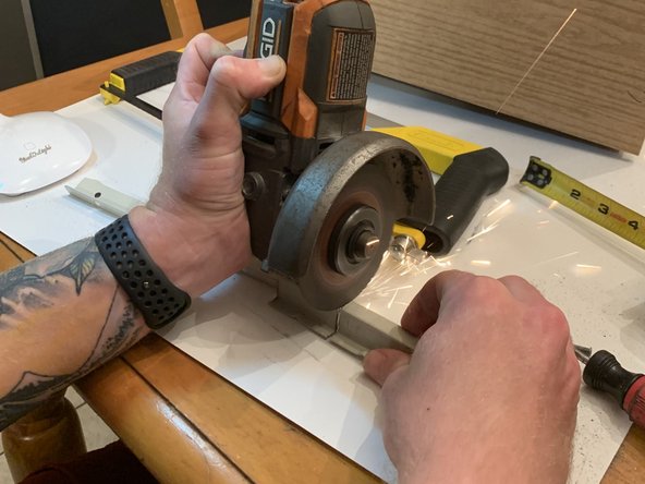

    • Remove the excess bracket. Make sure to remove parts of the bracket that do not contain holes. These holes are used for fasteners.
    • To cut a section, make sure you make perfectly vertical cuts for the remaining pieces to line up. To assure a straight line to cut, use a sharpie marker to mark a straight line.
    • Use a reciprocating power saw or a grinder with cutting wheel. I used a grinder because I found it to be easier.
    • Maintain eye protection, and gloves if necessary.

    • Use a drill with a drill bit to make necessary holes for screws to sit and fasten the bracket. Use a drill bit slightly larger than shaft of screws, but smaller than the head of the screws.
    • I used a 3/32 drill bit.
    • Install new fastener screws to the bracket.
    • My build required 12 #6x1/2inch Philips screws. I used three screws on each end of the brackets and six screws on each end of the bracket.
    • The more screws used, the stronger the bracket is secured. (Two on the bottom of the bracket, and one on the inside of the track.)
    • If possible, use preexisting holes, and screws.
    • Sometimes screws protrude too far, you may have to grind the head of the screw slightly so it protrudes less.
