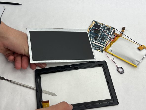

      • Use a plastic opening tool or spudger to carefully open the tablet's outer case. Start at the corners and work your way around. Be gentle to avoid damaging the case or any internal components.
    2. Dragon Touch Y88X Plus Screen Replacement: crwdns2935265:02crwdnd2935265:01crwdnd2935265:01crwdne2935265:0
      • Identify the tablet's battery. It is usually a flat, rectangular component connected to the motherboard.
    3. Dragon Touch Y88X Plus Screen Replacement: crwdns2935265:03crwdnd2935265:01crwdnd2935265:01crwdne2935265:0
      • Carefully peel the old battery from the adhesive using the Fixit pry tool.
      • Be very cautious not to puncture the battery

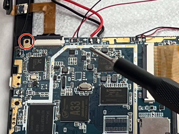

    4. Dragon Touch Y88X Plus Screen Replacement: crwdns2935265:04crwdnd2935265:01crwdnd2935265:02crwdne2935265:0 Dragon Touch Y88X Plus Screen Replacement: crwdns2935265:04crwdnd2935265:02crwdnd2935265:02crwdne2935265:0
      • Using a Phillips #00 screwdriver, remove the three 4 mm screws located around the motherboard.

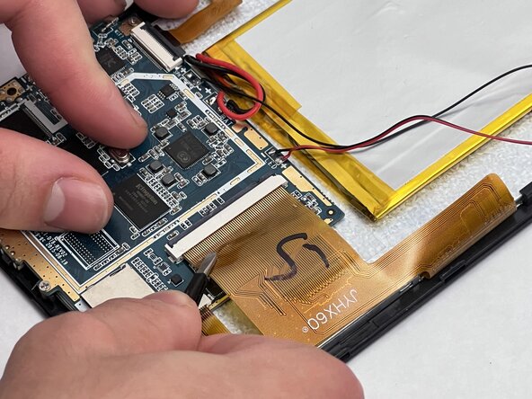

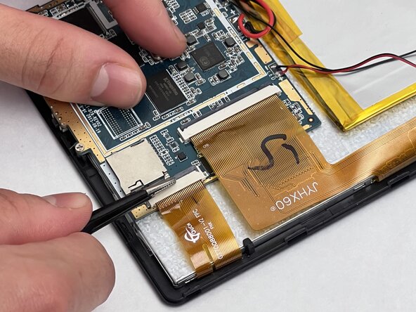

    5. Dragon Touch Y88X Plus Screen Replacement: crwdns2935265:05crwdnd2935265:01crwdnd2935265:02crwdne2935265:0 Dragon Touch Y88X Plus Screen Replacement: crwdns2935265:05crwdnd2935265:02crwdnd2935265:02crwdne2935265:0
      • Locate the ribbon cables that connect the screen to the tablet's motherboard and disconnect them. Make sure to note how these cables are attached so that you can reassemble them correctly later.
      • To remove the ribbons, flip the black switch where they are connected to the motherboard and gently pull the ribbons out.
    6. Dragon Touch Y88X Plus Screen Replacement: crwdns2935265:06crwdnd2935265:01crwdnd2935265:02crwdne2935265:0 Dragon Touch Y88X Plus Screen Replacement: crwdns2935265:06crwdnd2935265:02crwdnd2935265:02crwdne2935265:0
      • Use the plastic opening tool or spudger to pry the old screen away from the tablet carefully. Work your way around the edges, applying gentle pressure.
      • To remove the screen, you might need to utilize the metal spudger with the iFixit plastic pry tool.
