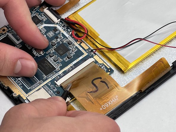

Dragon Touch Y88X Plus Motherboard Replacement
  1. Dragon Touch Y88X Plus Motherboard Replacement, Motherboard: crwdns2935265:01crwdnd2935265:01crwdnd2935265:01crwdne2935265:0
    • Remove the back case using a plastic opening tool or spudger.
    • Start at the corners and work your way around the perimeter of the tablet.
    • Be gentle to avoid damaging the case or any internal components.
  2. Dragon Touch Y88X Plus Motherboard Replacement: crwdns2935265:02crwdnd2935265:01crwdnd2935265:01crwdne2935265:0
    • Remove any adhesive strips keeping wires in place.
  3. Dragon Touch Y88X Plus Motherboard Replacement: crwdns2935265:03crwdnd2935265:01crwdnd2935265:01crwdne2935265:0
    • Desolder the wires connected to the motherboard to disconnect the battery and speaker.
  4. Dragon Touch Y88X Plus Motherboard Replacement: crwdns2935265:04crwdnd2935265:01crwdnd2935265:02crwdne2935265:0 Dragon Touch Y88X Plus Motherboard Replacement: crwdns2935265:04crwdnd2935265:02crwdnd2935265:02crwdne2935265:0
    • Use the tip of a spudger or your fingernail to flip up the small locking flap on the three ZIF connectors.
    • Be sure to pry up on the hinged flap, not the connector socket.
    • Use a spudger to slide the ribbon cables from the connectors.
  5. Dragon Touch Y88X Plus Motherboard Replacement: crwdns2935265:05crwdnd2935265:01crwdnd2935265:01crwdne2935265:0
    • Use a Phillips #00 screwdriver to remove the three 4 mm screws from the edges of the motherboard.
  6. Dragon Touch Y88X Plus Motherboard Replacement: crwdns2935265:06crwdnd2935265:01crwdnd2935265:01crwdne2935265:0
    • Gently lift the motherboard from the device.
