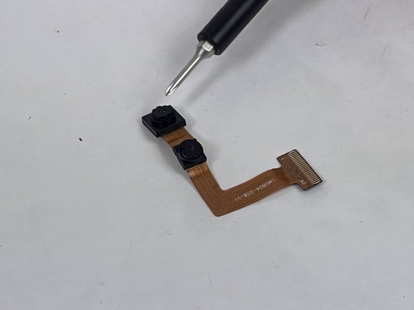

Dragon Touch Y88X Plus Camera Replacement
    1. Dragon Touch Y88X Plus Camera Replacement, Camera: crwdns2935265:01crwdnd2935265:01crwdnd2935265:02crwdne2935265:0 Dragon Touch Y88X Plus Camera Replacement, Camera: crwdns2935265:01crwdnd2935265:02crwdnd2935265:02crwdne2935265:0
      • First, start by removing the backplate from the device using your IFixit opening tool.
    2. Dragon Touch Y88X Plus Camera Replacement: crwdns2935265:02crwdnd2935265:01crwdnd2935265:01crwdne2935265:0
      • Next, remove any adhesives that are keeping internal components of the device in place.
    3. Dragon Touch Y88X Plus Camera Replacement: crwdns2935265:03crwdnd2935265:01crwdnd2935265:01crwdne2935265:0
      • Carefully peel the old battery from the adhesive using your iFixit pry tool.
    4. Dragon Touch Y88X Plus Camera Replacement: crwdns2935265:04crwdnd2935265:01crwdnd2935265:02crwdne2935265:0 Dragon Touch Y88X Plus Camera Replacement: crwdns2935265:04crwdnd2935265:02crwdnd2935265:02crwdne2935265:0
      • In order to remove the old camera, you must disconnect the ribbon that connects to the camera.
      • To remove the ribbon, flip the black switch where it is connected to the motherboard and gently pull the ribbon out and replace it with your replacement Dragon Touch Y88X Plus camera.
