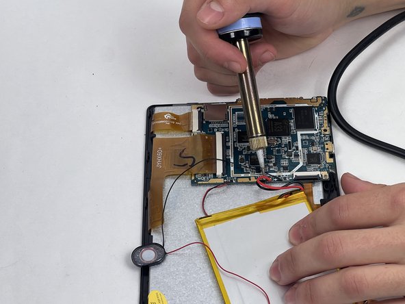

    • Remove the back case using a plastic opening tool or spudger.
    • Start at the corners and work your way around the perimeter of the tablet.
    • Be gentle to avoid damaging the case or any internal components.
  2. Dragon Touch Y88X Plus Battery Replacement: crwdns2935265:02crwdnd2935265:01crwdnd2935265:02crwdne2935265:0 Dragon Touch Y88X Plus Battery Replacement: crwdns2935265:02crwdnd2935265:02crwdnd2935265:02crwdne2935265:0
    • Identify the tablet's battery. It is usually a flat, rectangular component connected to the motherboard.
    • Carefully peel the old battery from the adhesive using your iFixit pry tool.
    • Be very cautious not to puncture the battery if yours has expanded . If the battery is swollen, read the article on What to do with a swollen battery for assistance.
  3. Dragon Touch Y88X Plus Battery Replacement: crwdns2935265:03crwdnd2935265:01crwdnd2935265:02crwdne2935265:0 Dragon Touch Y88X Plus Battery Replacement: crwdns2935265:03crwdnd2935265:02crwdnd2935265:02crwdne2935265:0
    • Use a soldering iron to disconnect each connector individually from the motherboard.
  4. Dragon Touch Y88X Plus Battery Replacement: crwdns2935265:04crwdnd2935265:01crwdnd2935265:01crwdne2935265:0
    • Remove any adhesive from the battery.
    • Remove the battery.
