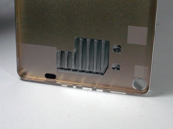

    • Ensure your buttons look like this
    • If either the buttons or the button holes in the back cover are dirty, clean them.
    • If the buttons are cracked or broken, they will have to be replaced
