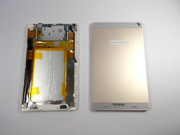

      • Use the large plastic opening tool to separate the back cover from the device. Wedge the sharp end of the tool into the crack and use leverage to further separate the back cover from the device.
      • Still holding pressure on the opening tool, slowly and carefully slide the tool along the gap to separate it further. You should hear slight snapping as it comes apart. Work your way around all sides until the cover is able to be removed.
    3. Dragon Touch M10X  Screen Replacement: crwdns2935265:03crwdnd2935265:01crwdnd2935265:02crwdne2935265:0 Dragon Touch M10X  Screen Replacement: crwdns2935265:03crwdnd2935265:02crwdnd2935265:02crwdne2935265:0
      • Using your hands and the separating tool, remove the back cover from the device.

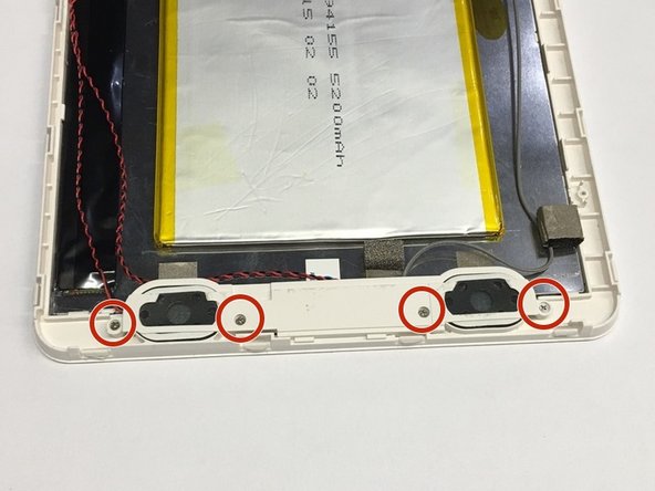

      • Using a J0 phillips head bit, remove the four 1mm screws from the speaker cover. Remove the cover and all four screws.

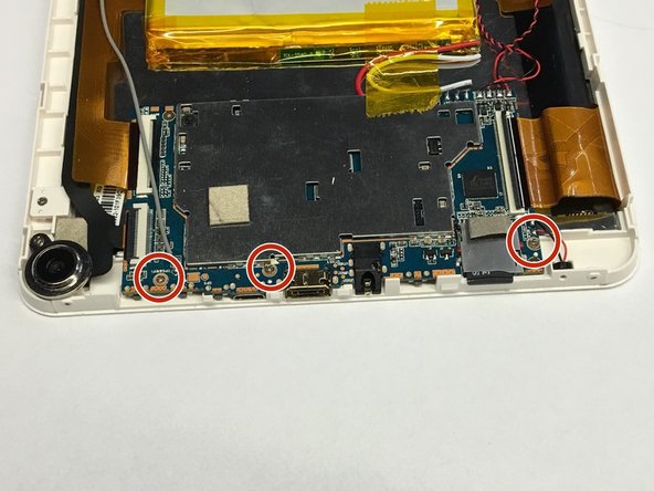

      • Using a J0 phillips head bit unscrew the three 1 mm screws from the motherboard as shown. Remove all three and place them aside.
