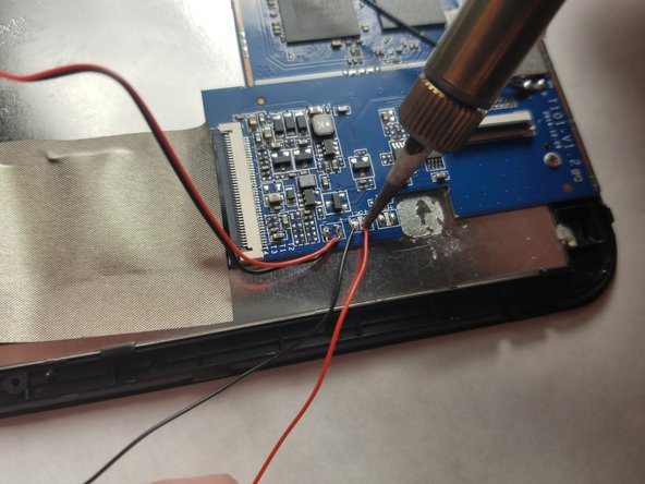

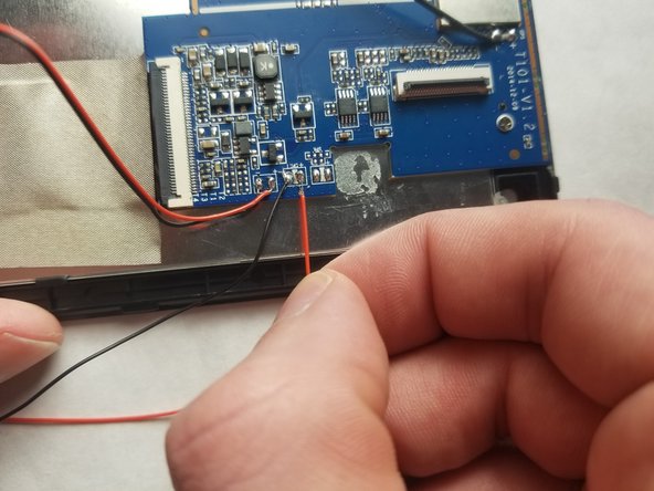

    • Desolder the red and black wires connecting the battery to the motherboard and remove the battery.
  7. Dragon Touch A1x Plus Speakers Replacement, Speakers: crwdns2935265:07crwdnd2935265:01crwdnd2935265:03crwdne2935265:0 Dragon Touch A1x Plus Speakers Replacement, Speakers: crwdns2935265:07crwdnd2935265:02crwdnd2935265:03crwdne2935265:0 Dragon Touch A1x Plus Speakers Replacement, Speakers: crwdns2935265:07crwdnd2935265:03crwdnd2935265:03crwdne2935265:0
    • Desolder the red and black wires connecting each speaker to the motherboard.
