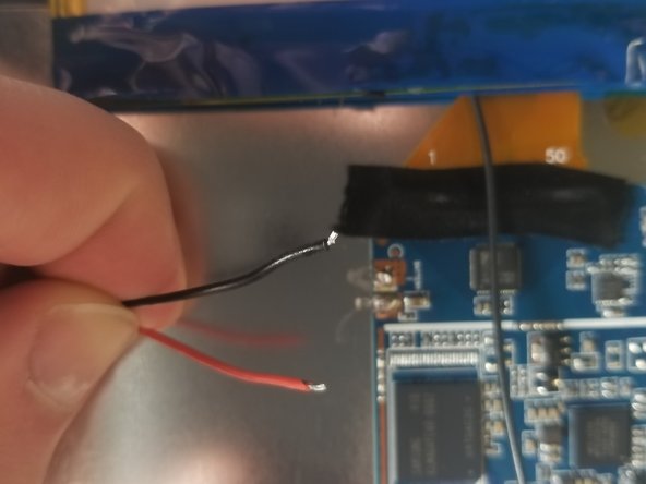

    • Desolder the red and black wires connecting the battery to the motherboard and remove the battery.

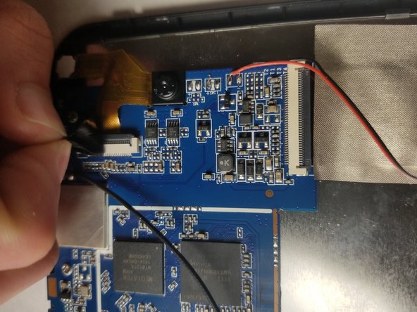

    • Remove black tape holding the cameras to the motherboard.

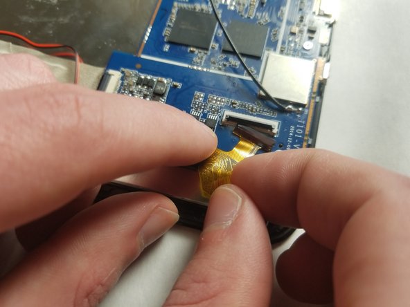

    • Use your fingernail to flip up the small locking flap on the ZIF connector.
    • Pull the ribbon cable from the ZIF connector.
  9. Dragon Touch A1x Plus Cameras Replacement: crwdns2935265:09crwdnd2935265:01crwdnd2935265:01crwdne2935265:0
    • Remove the front camera from the device using your fingers.

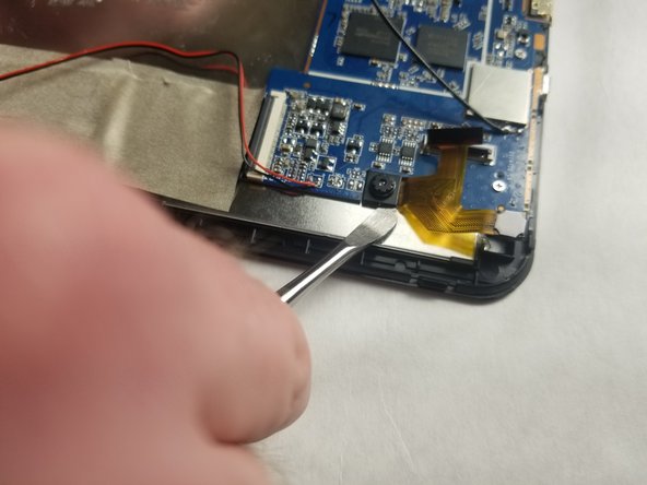

    • Melt the glue holding the rear camera in place using a hair dryer.
    • Insert the metal spludger under the rear camera and pry it free from the device.
