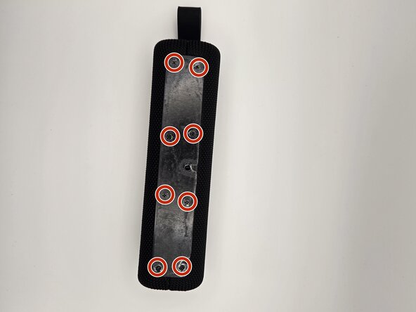

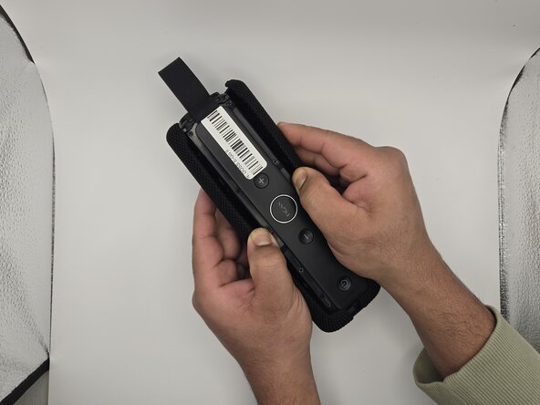

    • Peel the backing off of the speaker.
    • Remove eight 7.9 mm screws using the Phillips #00 screwdriver.
    • Gently pull apart the grille on the sides of the speaker.

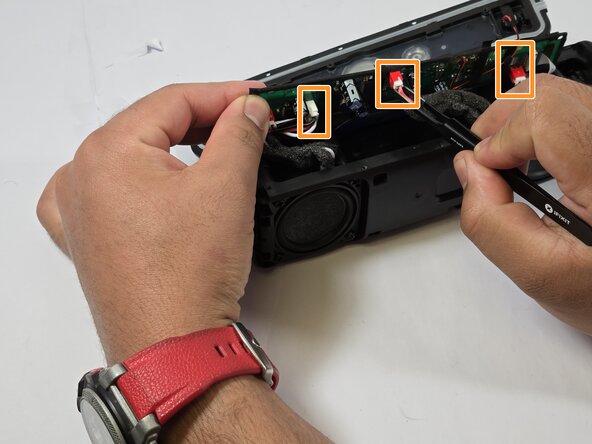

    • Remove seven 8 mm screws using a Phillips #00 screwdriver.
    • Detach the wire connections that connect to the motherboard to have easier access to the battery.
