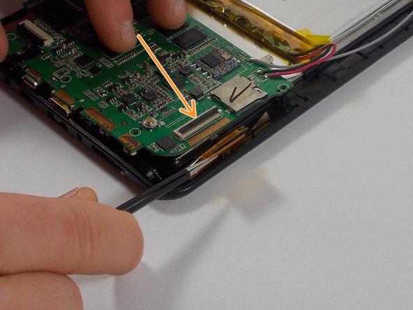

  6. Dopo Double Power 7 Motherboard Replacement: crwdns2935265:06crwdnd2935265:01crwdnd2935265:02crwdne2935265:0 Dopo Double Power 7 Motherboard Replacement: crwdns2935265:06crwdnd2935265:02crwdnd2935265:02crwdne2935265:0
    • Using the flat end of a spudger or tweezers, remove the three cables connected to the motherboard.
    • The cables can be disconnected by lifting up on the black section of the socket, as shown by the arrow.
    • Once the lever is lifted, pull out the cable by gently tugging on it.

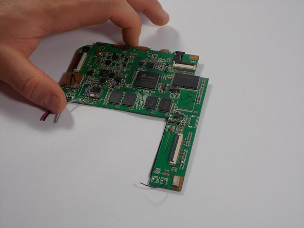

  8. Dopo Double Power 7 Motherboard Replacement: crwdns2935265:08crwdnd2935265:01crwdnd2935265:02crwdne2935265:0 Dopo Double Power 7 Motherboard Replacement: crwdns2935265:08crwdnd2935265:02crwdnd2935265:02crwdne2935265:0
    • Using wire cutters, cut the red, black, and grays wires.
    • The motherboard can now be removed
    • Leave enough wire to be re-soldered back if possible.
