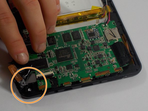

    2. Dopo Double Power 7 Digitizer Replacement: crwdns2935265:06crwdnd2935265:01crwdnd2935265:02crwdne2935265:0 Dopo Double Power 7 Digitizer Replacement: crwdns2935265:06crwdnd2935265:02crwdnd2935265:02crwdne2935265:0
      • The camera is taped in place.
      • Use the flat end of a spudger to disconnect the front-facing camera cable from its socket on the motherboard.
      • Our cable had previously been cut but yours can be disconnected by lifting up on the black section of the socket, as shown by the arrow, and pulling the cable out.
      • Simply, pull back the tape and remove the camera.

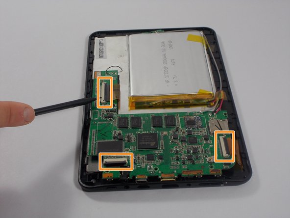

    1. Dopo Double Power 7 Digitizer Replacement, Digitizer: crwdns2935265:07crwdnd2935265:01crwdnd2935265:02crwdne2935265:0 Dopo Double Power 7 Digitizer Replacement, Digitizer: crwdns2935265:07crwdnd2935265:02crwdnd2935265:02crwdne2935265:0
      • Use a Phillips Head Screwdriver size 0.
      • Remove the four screws holding the motherboard inplace.
      • Using the flat end of a spudger or tweezers, remove the three cables connected to the motherboard.
      • The cables can be disconnected by lifting up on the black section of the socket.
      • Once the lever is lifted, pull out the cable by gently tugging on it.

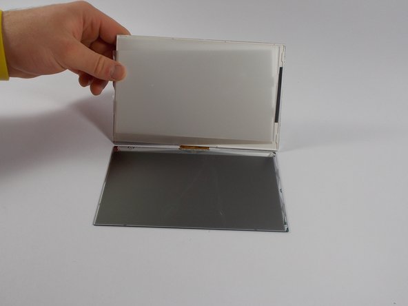

    6. Dopo Double Power 7 Digitizer Replacement: crwdns2935265:012crwdnd2935265:01crwdnd2935265:02crwdne2935265:0 Dopo Double Power 7 Digitizer Replacement: crwdns2935265:012crwdnd2935265:02crwdnd2935265:02crwdne2935265:0
      • The digitizer can now be removed and replaced.

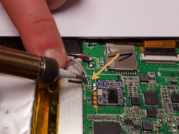

    7. Dopo Double Power 7 Digitizer Replacement: crwdns2935265:013crwdnd2935265:01crwdnd2935265:02crwdne2935265:0 Dopo Double Power 7 Digitizer Replacement: crwdns2935265:013crwdnd2935265:02crwdnd2935265:02crwdne2935265:0
      • Soldering will be required to connect the new digitizer.
      • Any remaining wire left from the old digitizer will need to be removed from the motherboard.
      • Take care not to burn yourself or damage the motherboard, wires, or new digitizer while soldering.
      • Solder the new digitizer to the soldering point shown within the image.
      • Using wire strippers, strip the end of the gray wire connected to the new digitizer about a 1/8".
      • Solder the gray wire to the soldering point on the motherboard as shown within the image.
