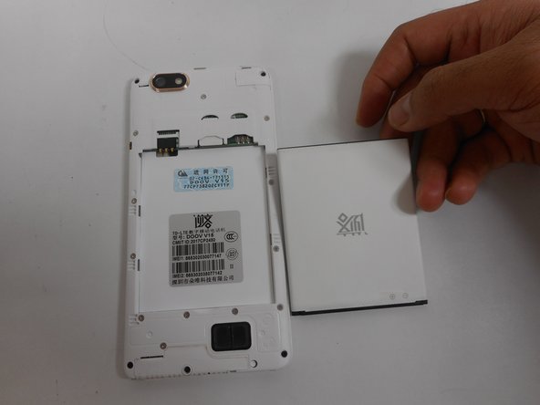

  3. Doov v15 Speaker Replacement: crwdns2935265:03crwdnd2935265:01crwdnd2935265:02crwdne2935265:0 Doov v15 Speaker Replacement: crwdns2935265:03crwdnd2935265:02crwdnd2935265:02crwdne2935265:0
    • Disconnect the Battery: Once the back casing is removed, the battery will be visible. Use the ifixit opening tool to remove the battery. Place the ifixit opening tool at the top of the battery and pull it back, or simply use your hand to remove it.

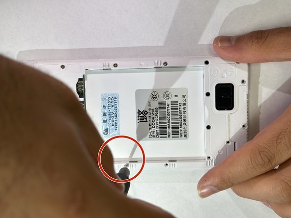

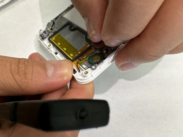

  4. Doov v15 Speaker Replacement: crwdns2935265:04crwdnd2935265:01crwdnd2935265:03crwdne2935265:0 Doov v15 Speaker Replacement: crwdns2935265:04crwdnd2935265:02crwdnd2935265:03crwdne2935265:0 Doov v15 Speaker Replacement: crwdns2935265:04crwdnd2935265:03crwdnd2935265:03crwdne2935265:0

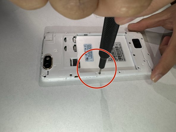

    • Onec you disconnect the battery now use iFixit Precision Bit Driver and iFixit Precision 4 mm Screwdriver Oval Drive Bit (0.5). Place the Screwdriver in the top of screw and rotate it clock wise until the screw comes out.
    • Remember to use magnetic mat to keep those tiny screw safe so that you will not lose it. Repeat the steps and unscrew all the screw.

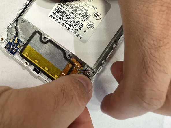

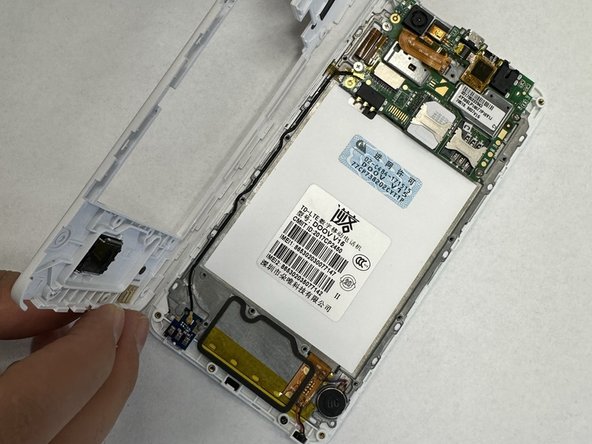

  5. Doov v15 Speaker Replacement: crwdns2935265:05crwdnd2935265:01crwdnd2935265:03crwdne2935265:0 Doov v15 Speaker Replacement: crwdns2935265:05crwdnd2935265:02crwdnd2935265:03crwdne2935265:0 Doov v15 Speaker Replacement: crwdns2935265:05crwdnd2935265:03crwdnd2935265:03crwdne2935265:0

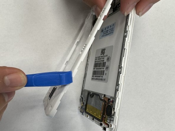

    • After finishing unscrewing, use plastic opening tools to gently pry open the device. Be cautious to avoid damaging internal components.
    • Note: slide it around like you did in step 2 and take out the frame.

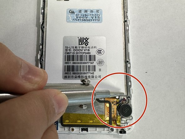

  6. Doov v15 Speaker Replacement: crwdns2935265:06crwdnd2935265:01crwdnd2935265:03crwdne2935265:0 Doov v15 Speaker Replacement: crwdns2935265:06crwdnd2935265:02crwdnd2935265:03crwdne2935265:0 Doov v15 Speaker Replacement: crwdns2935265:06crwdnd2935265:03crwdnd2935265:03crwdne2935265:0

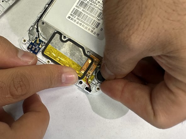

    • Locate and disconnect the old speaker: After taking out the plastic frame on right bottom corner you will see round speaker, you can test it with the help screw driver, you will feel magnetic power.
  7. Doov v15 Speaker Replacement: crwdns2935265:07crwdnd2935265:01crwdnd2935265:03crwdne2935265:0 Doov v15 Speaker Replacement: crwdns2935265:07crwdnd2935265:02crwdnd2935265:03crwdne2935265:0 Doov v15 Speaker Replacement: crwdns2935265:07crwdnd2935265:03crwdnd2935265:03crwdne2935265:0
    • Carefully disconnect any cables or connectors attached to it. Remove any screws securing the speaker in place. Gently lift the old speaker out of its position.
    • Replace the new speaker in the place of old speaker and with the help of soldering Gun connect all the cables and any connectors back.
