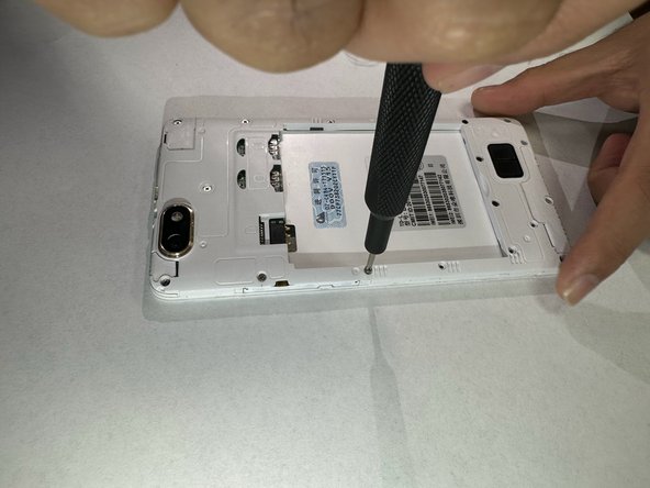

    • Use the Jimmy to crack open the phone's back cover. Slide it under an edge of the phones back cover and carefully loosen the edge. The casing should pop open slightly.

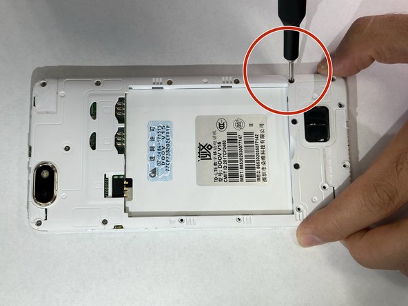

    • Use an ifixit opening tool to slide around the phones back cover, loosening it and allowing for an easy removal. It should easily separate from the chassis. Make sure to trace it around the entire phone.
    • Disconnect the Battery: Once the back casing is removed, the battery will be visible. Use the ifixit opening tool to remove the battery. Place the ifixit opening tool at the top of the battery and pull it back, or simply use your hand to remove it.

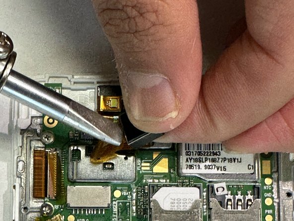

    • Once you disconnect the battery, use the iFixit Precision Bit Driver and iFixit Precision 4 mm Screwdriver Oval Drive Bit (0.5). Start unscrewing each screw clock wise until they come out. Repeat the steps and unscrew all the screw.
    • Make sure to keep the screws together in a bag or magnetic mat to ensure they aren't lost or misplaced.

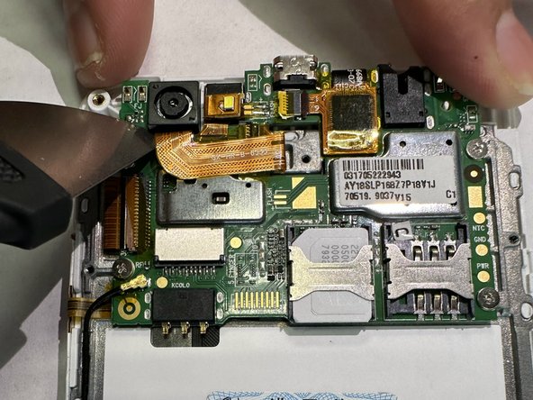

    • After all screws are removed, use the iFixit opening tool to gently pry open and seperate the chassis.
    • Be cautious to avoid damaging internal components. Slide it around the phone to loosen it and gently remove the chassis.
