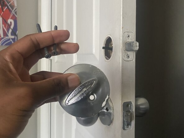

    1. Doorknob Privacy Pin Replacement, Doorknob Privacy Pin: crwdns2935265:01crwdnd2935265:01crwdnd2935265:03crwdne2935265:0 Doorknob Privacy Pin Replacement, Doorknob Privacy Pin: crwdns2935265:01crwdnd2935265:02crwdnd2935265:03crwdne2935265:0 Doorknob Privacy Pin Replacement, Doorknob Privacy Pin: crwdns2935265:01crwdnd2935265:03crwdnd2935265:03crwdne2935265:0

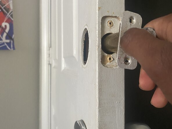

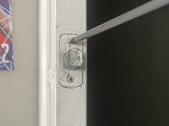

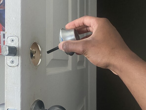

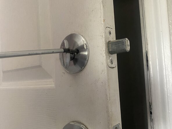

      • Use a Phillips #1 screwdriver to remove the two screws holding the interior and exterior doorknob halves together.

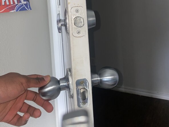

    2. Doorknob Privacy Pin Replacement: crwdns2935265:02crwdnd2935265:01crwdnd2935265:02crwdne2935265:0 Doorknob Privacy Pin Replacement: crwdns2935265:02crwdnd2935265:02crwdnd2935265:02crwdne2935265:0

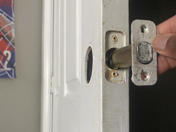

      • Carefully pull the doorknob halves apart.
      • The spindle and the latch mechanism should now be accessible.

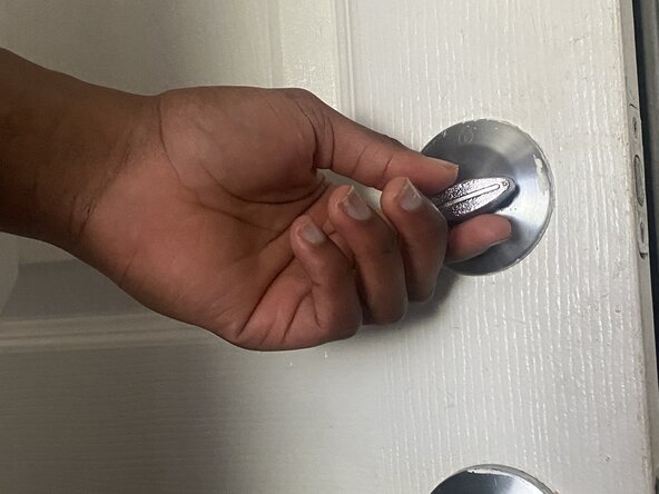

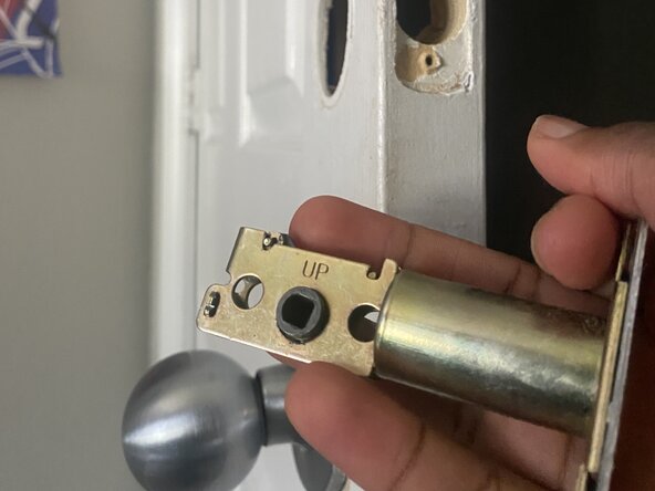

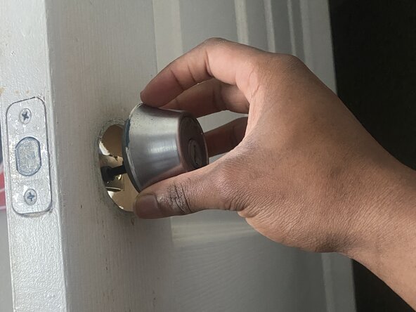

    3. Doorknob Privacy Pin Replacement: crwdns2935265:03crwdnd2935265:01crwdnd2935265:03crwdne2935265:0 Doorknob Privacy Pin Replacement: crwdns2935265:03crwdnd2935265:02crwdnd2935265:03crwdne2935265:0 Doorknob Privacy Pin Replacement: crwdns2935265:03crwdnd2935265:03crwdnd2935265:03crwdne2935265:0
      • Use the Phillips #1 screwdriver to remove the privacy pin.
      • It is a small, threaded pin that screws into a hole on the latch mechanism itself or on the interior doorknob assembly.

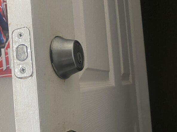

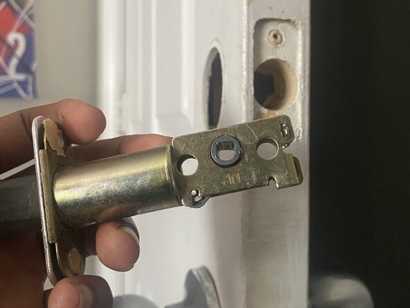

    4. Doorknob Privacy Pin Replacement: crwdns2935265:04crwdnd2935265:01crwdnd2935265:01crwdne2935265:0
      • Remove the old/ damaged privacy pin.

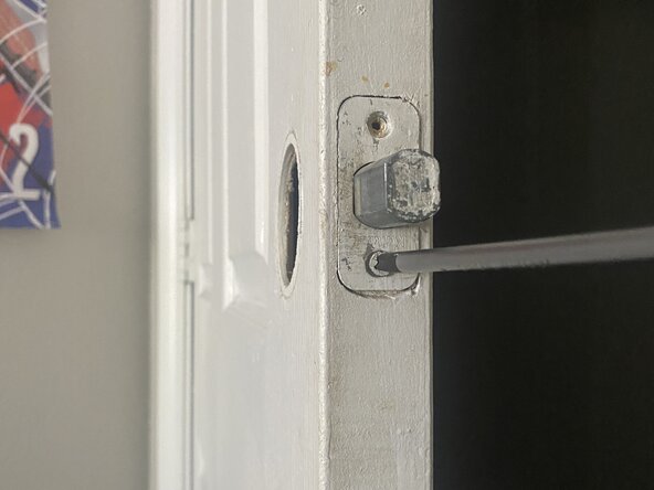

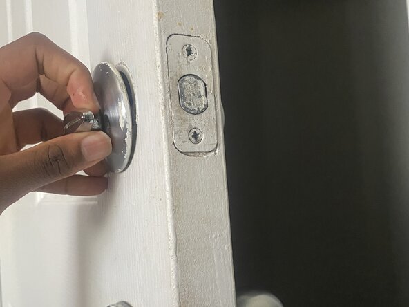

    5. Doorknob Privacy Pin Replacement: crwdns2935265:05crwdnd2935265:01crwdnd2935265:03crwdne2935265:0 Doorknob Privacy Pin Replacement: crwdns2935265:05crwdnd2935265:02crwdnd2935265:03crwdne2935265:0 Doorknob Privacy Pin Replacement: crwdns2935265:05crwdnd2935265:03crwdnd2935265:03crwdne2935265:0
      • Screw the new privacy pin into the corresponding hole.
      • Ensure it's securely tightened but don't overtighten, as this could strip the threads.

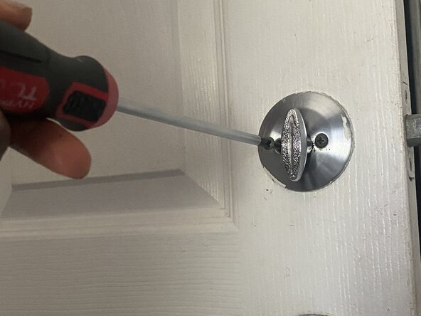

    6. Doorknob Privacy Pin Replacement: crwdns2935265:06crwdnd2935265:01crwdnd2935265:03crwdne2935265:0 Doorknob Privacy Pin Replacement: crwdns2935265:06crwdnd2935265:02crwdnd2935265:03crwdne2935265:0 Doorknob Privacy Pin Replacement: crwdns2935265:06crwdnd2935265:03crwdnd2935265:03crwdne2935265:0
      • Align the spindle with the latch mechanism, then bring the two doorknob halves back together.
      • Make sure all parts are properly seated.

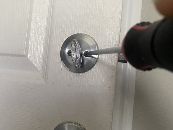

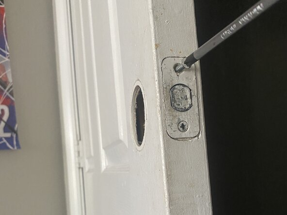

    7. Doorknob Privacy Pin Replacement: crwdns2935265:07crwdnd2935265:01crwdnd2935265:03crwdne2935265:0 Doorknob Privacy Pin Replacement: crwdns2935265:07crwdnd2935265:02crwdnd2935265:03crwdne2935265:0 Doorknob Privacy Pin Replacement: crwdns2935265:07crwdnd2935265:03crwdnd2935265:03crwdne2935265:0
      • Securely fasten the two screws with the Phillips #1 screwdriver.
      • Snap or twist the decorative covers back into place (If applicable).
      • Test the privacy pin several times to ensure it engages and disengages smoothly.
