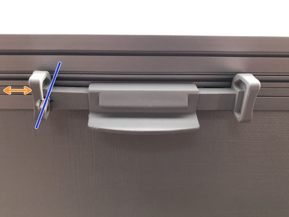

    • This step shows the problem again for analysis and confirmation.
    • When the lock is pressed...
    • the slider no longer moves or...
    • the hole is visible after pressing
  2. Dometic S4 pop-up window Blinds lock repair, Solution description: crwdns2935265:02crwdnd2935265:01crwdnd2935265:03crwdne2935265:0 Dometic S4 pop-up window Blinds lock repair, Solution description: crwdns2935265:02crwdnd2935265:02crwdnd2935265:03crwdne2935265:0 Dometic S4 pop-up window Blinds lock repair, Solution description: crwdns2935265:02crwdnd2935265:03crwdnd2935265:03crwdne2935265:0
    • This explanation is intended to help you understand the following steps
    • To solve the problem...
    • a wooden stick (shashlik skewer) is passed through a hole in the catch...
    • which ends in the hole behind it and...
    • thereby taking the slider with it again...
    • and restores the function in the long term
