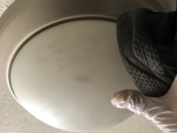

    • Before you start anything, make sure that the light switch has been turned off to avoid any electrical problems.
    • Gently turn the light in a counterclockwise direction with a gloved hand.
    • If the light is stuck, you can use the the grippier sole of a shoe to lightly nudge the light loose.
    • When the light starts moving enough, spin the light counterclockwise with the glove until it comes off.

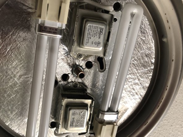

    • Turn the light on without the cover to determine which bulb is blown out.
    • You can also check if the light looks black near the connection as a symbol it is going bad.
    • Turn off the power from the circuit breaker and turn off any light switches that provide power to the item you’re working on.

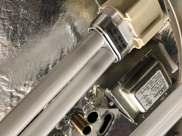

  4. Dome Ceiling Light Bulb Replacement: crwdns2935265:05crwdnd2935265:01crwdnd2935265:02crwdne2935265:0 Dome Ceiling Light Bulb Replacement: crwdns2935265:05crwdnd2935265:02crwdnd2935265:02crwdne2935265:0

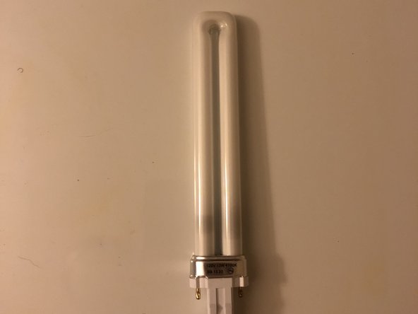

    • Pull out the old burnt light, being sure not to drop it.
    • Plug the new replacement light into the plug in the light fixture.
    • In my case the bulb was a 120v 13w 4100k. This can very depending on model of light unit.
    • Watch how your light is supposed to match up with the plug when putting the new light in.

  6. Dome Ceiling Light Bulb Replacement: crwdns2935265:07crwdnd2935265:01crwdnd2935265:02crwdne2935265:0 Dome Ceiling Light Bulb Replacement: crwdns2935265:07crwdnd2935265:02crwdnd2935265:02crwdne2935265:0
    • Spin the lid clockwise with your gloved hand until you can't turn it anymore.
    • Hit the lid clockwise with the heel of the shoe to tighten up the lid and avoid any accidents and loose ends.
