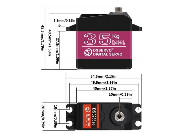

  2. Dolphin i 300 Pool Roboter Servo Replacement, Bring the new servo in the middle position: crwdns2935265:02crwdnd2935265:01crwdnd2935265:01crwdne2935265:0
    • By hand or with a arduino code. The servo and the mechanics has to be both in the middle position.
    • #include <Servo.h> Servo myservo; void setup() { myservo.attach(A2); } void loop() { myservo.write(50); // set servo to mid-point delay(2000); myservo.write(90); // set servo to mid-point delay(8000); myservo.write(1400); // set servo to mid-point delay(2000);
    • This needs to be done carefully.

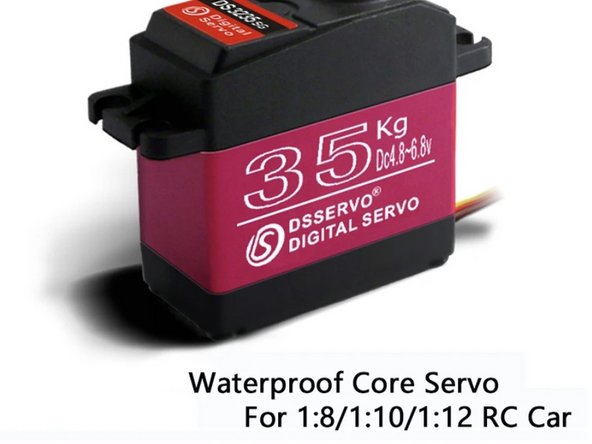

  3. Dolphin i 300 Pool Roboter Servo Replacement, Solder the new servo and mount it: crwdns2935265:03crwdnd2935265:01crwdnd2935265:03crwdne2935265:0 Dolphin i 300 Pool Roboter Servo Replacement, Solder the new servo and mount it: crwdns2935265:03crwdnd2935265:02crwdnd2935265:03crwdne2935265:0 Dolphin i 300 Pool Roboter Servo Replacement, Solder the new servo and mount it: crwdns2935265:03crwdnd2935265:03crwdnd2935265:03crwdne2935265:0
    • With the Arduino code you can test the alignement. There is a alignment mark on the bot itself.
    • The Servo can do 180 degrees, the robot needs around 120, so there is margin from the servo but NOT from the mechanics.
    • If the jet mechanic is at the stop and the servo want to go further, it will end with a loss. IMHO you can dare it by just by hand.
    • Try it out.
    • Keep in mind the bot needs some time to start all the movements. You can also try with the app with manual control.

Bonjour. 35kg de force pour un si petit servo ?
Arnaud Bourgeois - crwdns2934203:0crwdne2934203:0
I assume you can take a smaller one but they are cheap. I took this model because it was labeled waterproof. Works like a breeze ever since.
