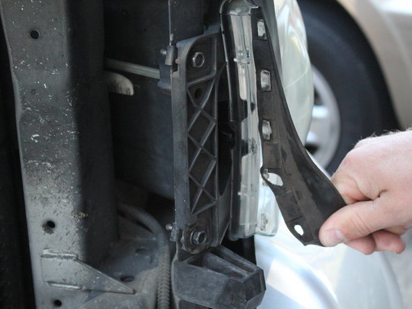

  4. Dodge Ram 1500 Headlight Bulb Replacement: crwdns2935265:04crwdnd2935265:01crwdnd2935265:02crwdne2935265:0 Dodge Ram 1500 Headlight Bulb Replacement: crwdns2935265:04crwdnd2935265:02crwdnd2935265:02crwdne2935265:0
    • Approach this step with the process of unbuttoning a shirt in mind.
    • Be careful if the rubber gasket is dry-rotted. Use vaseline to re-moisturize if necessary. Manipulating dry-rotted rubber will result in tearing.
    • Pinch the bottom of the rubber gasket at the left side of the assembly and remove it from the plastic "buttons" on the headlight assembly.
