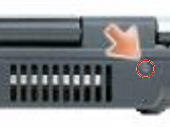

      • Turn the computer upside down with the back of the computer facing you.
    1. Display Assembly, Remove the Screws: crwdns2935265:02crwdnd2935265:01crwdnd2935265:01crwdne2935265:0
      • From the bottom of the computer, remove the two M2.5 x 8-mm screws labeled "D."
    2. Display Assembly, Remove the Screws: crwdns2935265:03crwdnd2935265:01crwdnd2935265:02crwdne2935265:0 Display Assembly, Remove the Screws: crwdns2935265:03crwdnd2935265:02crwdnd2935265:02crwdne2935265:0
      • From the back of the computer, remove the two M2.5 x 8-mm screws labeled "D."
