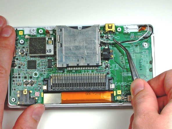

  10. Disconnecting Nintendo DS Lite Logic Board: crwdns2935265:010crwdnd2935265:01crwdnd2935265:03crwdne2935265:0 Disconnecting Nintendo DS Lite Logic Board: crwdns2935265:010crwdnd2935265:02crwdnd2935265:03crwdne2935265:0 Disconnecting Nintendo DS Lite Logic Board: crwdns2935265:010crwdnd2935265:03crwdnd2935265:03crwdne2935265:0
    • Locate the black and white cables that are attached to the logic board and WiFi module.
    • Using metal tweezers, gently disconnect the wires by pulling them away from the logic board and underneath the card slot.
    • Do not pull the wires with force; they will detach.
